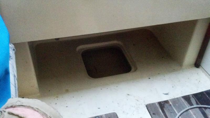

I have an 83 Hunter 22 and there is a small opening in the back
What is it?
Also, there is water in it, how does it drain. again, What is it?
Thanks
319
Hunter 29.5 Gloucester, VA
When we had our 22 it often got water back there. It doesn't drain. We had to get a hand pump and pump it out.

It’s the access to the “main” bilge. It’s not the lowest point in that bilge, ..either side of the swing keel trunk where the keel bolts are located are THE lowest points for that bilge. That small aft access you refer to is where I have one of my two bilge pumps installed. There are three separate bilges in the H22…of varying sizes.

Thanks guys! This is a totally new boat to me and I am learning her quirks.
So that does not drain. seems like a great idea.

What exactly do you mean by "...So that does not drain" ? Where do you expect it to drain to? ALL of the bilges are lower than the cockpit drains. You've either got to hand pump them, or install electric pumps...OR best of all, find and stop all leaks.
There are not too many below the waterline thru-hulls to speak of for the H22:
1-- keel mounting bolts,
2-- underwater log on port side of swing keel trunk under storage location just aft of the bulkhead,
3 -- the galley sink drain under the port quarter berth, and
4 -- the common cockpit drain fed by the two cockpit scuppers all the way aft.
Intermittent leakage may come from the forward anchor locker / bow eye area.
