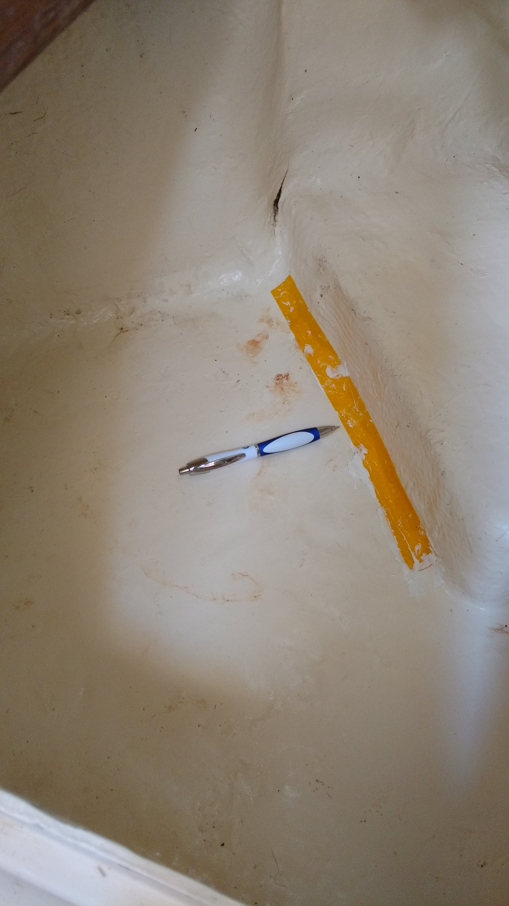

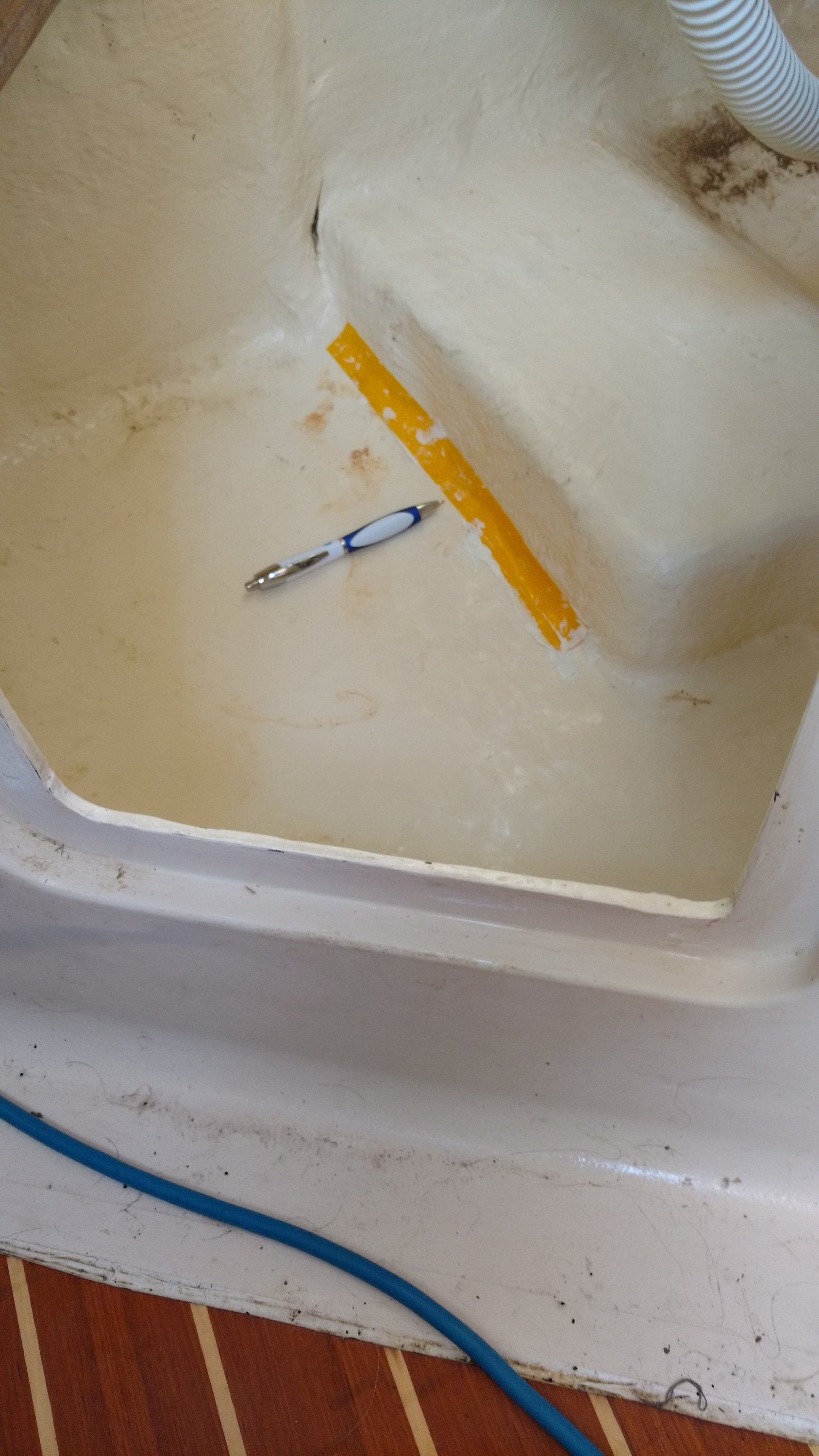

I have a similar problem on my H26, but I think it is from a different cause. I have water entering the area under the galley sink from a small crack under the forward galley locker door. The crack appears to be a manufacturing flaw at the joint between the liner and the top of the ballast tank. I am relatively certain that the water is coming from the top of the ballast tank, where I forgot to close it while we were underway. I have remedied the problem of the leak from the ballast tank by closing the valve and tightening up the stopper ( which, of course, I should have done in the first place anyway). I have also cleaned up the other water in the bilge compartment at further aft. The problem is, that I do not know how to dry out the bilge area underneath the cabin sole where the water is leaking from. Eventually, it will probably all dry out, but I have to heal the boat to try to get it to flow out through the small hole under the galley. I am sure that I will not be able to get it all out this way. Does anyone have any experience on how to dry out this area which seems to be about any convenient access? The photos with the Marlin Spike as a pointer show the flaw in the gallery locker.
Thanks in advance for any wisdom you can impart.

send me a private message with phone number and lets talk. Your contact info is held private and deleted afterwards. Rather cut to the chase as I have a lot of questions. If anything guys I will report back
10,536
-na -NA Anywhere USA
Spoke with Cactus Sailor. No leak from transom or water seeping over ballast tank lid into bilge area. Dry coming from rear berth into galley... He did forgot to close water ballast controls once recently. He says it is less and getting less. If it continues My thought it is a break between the W B tank lid bonded to the floor coming thru that weep hole. Boat would neeed to come out of the water, dremel out void,, apply two part epoxy and refiberglass seam with three layers smoothing out with chip brush dipped in acetone to smooth out and get rid of air bubbles and then paint. He has my number and will monitor the situation.
