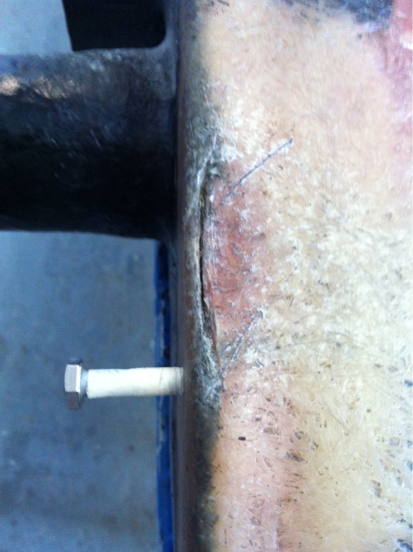

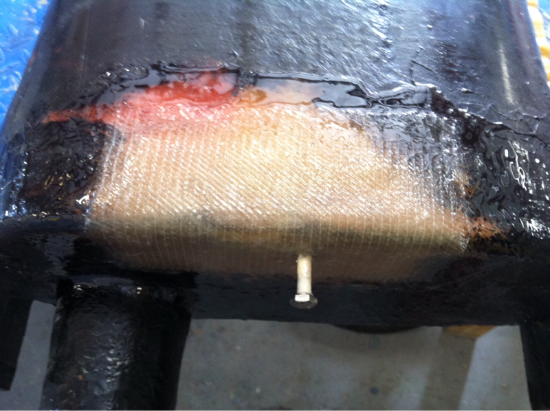

I had salt water under the gear box. The cause was a chafed muffler. The muffler is held in place by screws and foam, but apparetly could still move enough to chafe through the bonding from the mufflers hull and the front plate (all GRP). I had to remove the muffler to find the leak and I'm aware that I'm not the only Hunter owner with a chafed leaking muffler!
May 21, 2013
45
Hunter 410 Stuart
Here are the pictures:
