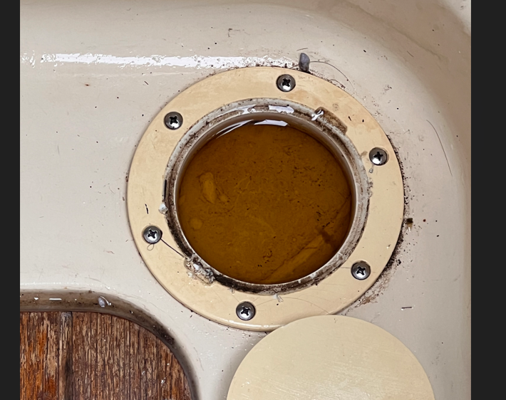

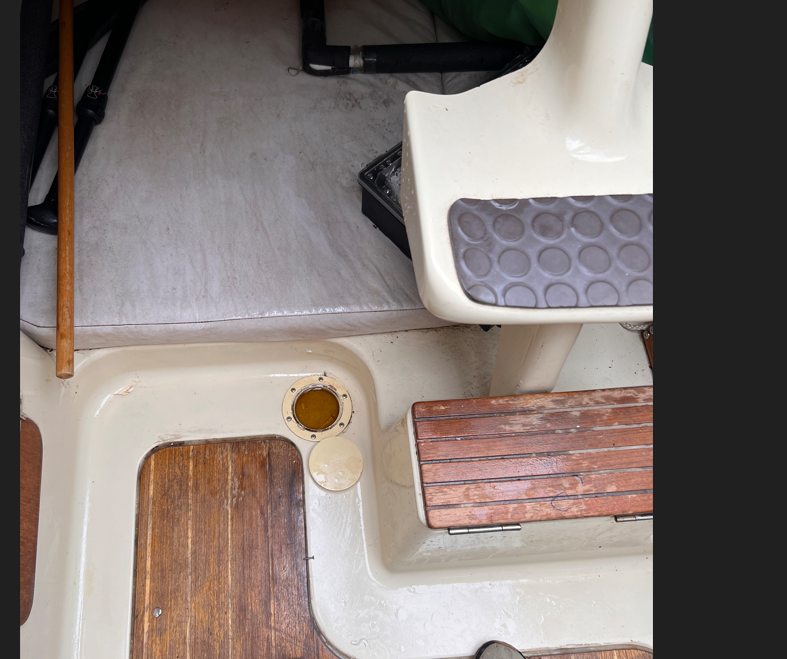

Does it look like this?
My water-ballast 1996 Hunter 26 gets water under the cabin sole. I drain it completely dry every season, and, when I put the boat in the water and check the inspection port, it has refilled. I have two questions: 1) Is this a problem I can just live with? and 2) What is the source of this water? Thanks in advance for any advice on this issue.

I spoke with the poster. The boat was out of the water being covered for the winter. First I cautioned laying over the mast but I was informed the mast was being supported from underneath. Secondly I advised That the inspection port was added by Hunter personnel but stpped as it was not needed since I advised I could reach that area with my hand from underneath from under the rear berth
The poster advised that the cabin floor was secure and did not feel the top of the water ballast tank lid was not sloshing. I did not ask if water was seen on the teak and holly floor after a rain.
I suggested to check for topside leaked by pressuring the cabin with another person by brushing soapy water on all fittings on the top of the decks to see if air is coming out. He has decided to wait till spring as the boat has been removed from the water and winterized. He will contact us next spring
