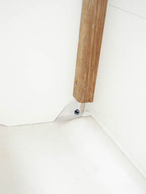

I'm in the process of moving my batteries into the port side wet locker in the back of the head in my H260. In the process of checking all the surrounding bulkheads for thickness and construction I noticed a small notch cut out on the bottom of the forward wall, below where the anti-siphon hoses go into the locker. You have to use a mirror to see this as the space is very narrow and back in the corner of the head. This appears to be where it was intended the "wet" from the locker would exit into the bilge. However, there is a fiberglass flange (wall) behind the notch and in assembling the fiberglass liner pieces, someone either forgot to drill through the flange at the edge of the fiberglass liner, or the designer forgot to put a hole on the plans. The wet locker holds water very tightly. So, after exploring in the bilge, ( I used a mirror and flashlight cuz I'm not that small... ;^) to be sure I wouldn't drill through something like the balast tank or the waste hose. I drilled through the fiberglass flange. (see the attached photo) I will now probably make the hole a little larger so it does not plug up easily. You may want to check your wetlocker to see if you have a drain hole that works.In the next few days I'll make a mold of the bottom of the locker with plastic sheeting, then create a foam insert to fit into the bottom 5 inches, to built up a flat surface. Then I'll move my batteries into the locker. An engineer in our office said the foam plug should easily hold and distribute the weight of the batteries. The battery cables then run through the bilge over to the galley cabinet and up to the switch panel. This will help remove the starboard list caused by the batteries and motor on the same side. I'll take pictures of the project along the way and put them in the photo forum here and on my sailing web site.Brigg
