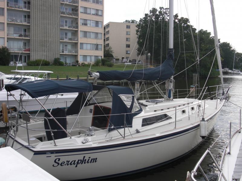

My 34 was built in 1984 a 25 year anniversary addition. There is one vent fitting forward of the mast on each side of the hull for the holding tank only. I will attach a picture of the starboard side if I can figure out how to do it.

You don't need two vents for your holding tank. It looks like someone modified your boat. Whatever you do don't combine vents for the holding tank and fresh water system. Their is a third vent for the holding tank, also one near the stern for the fuel tank. So go around your boat identify them all then figure out how to hook them up properly.
