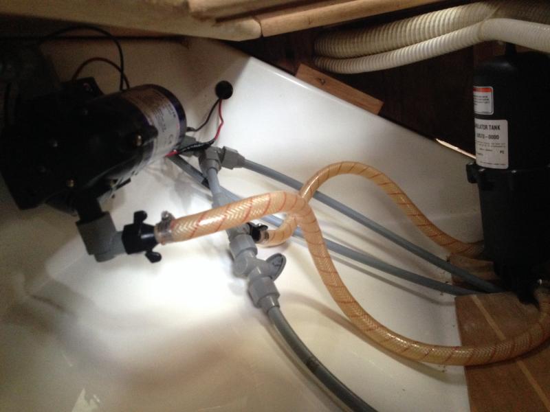

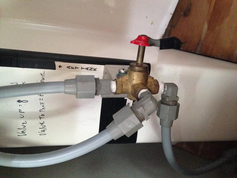

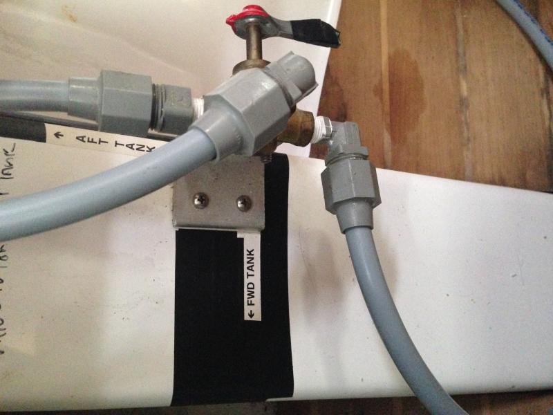

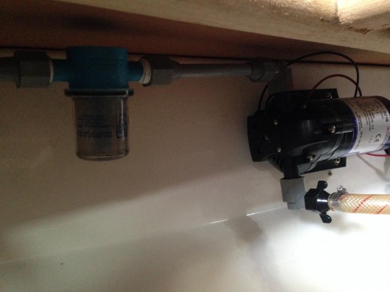

1986 Hunter H34:
I'm looking to modify my water tank supply system in order to feed water from both tanks simultaneously. The current configuration allows me to feed from either the aft tank or the starboard tank or shutoff. I'm curious as to the advantages and disadvantages of doing this as well as the best method of reconfiguring the system.
Pro's
- Convenience of not having to switch tanks manually
- less likely to run the water pump dry
Con's
- possible uneven feed from tanks
- possible air entering the line
- possible cross tank contamination if not isolated
- other unknown possibilities
Whats the best procedure for accomplishing this? My current assumption is that replacing the current three way valve with a valve which allows the use of either tank 1 or tank 2 or both or shutoff. I'm not sure how best to describe this type of valve. Other ideas would be to splice into the tank supply lines which feed the valve and insert a bypass with a separate one way valve in order to connect both tanks together.
