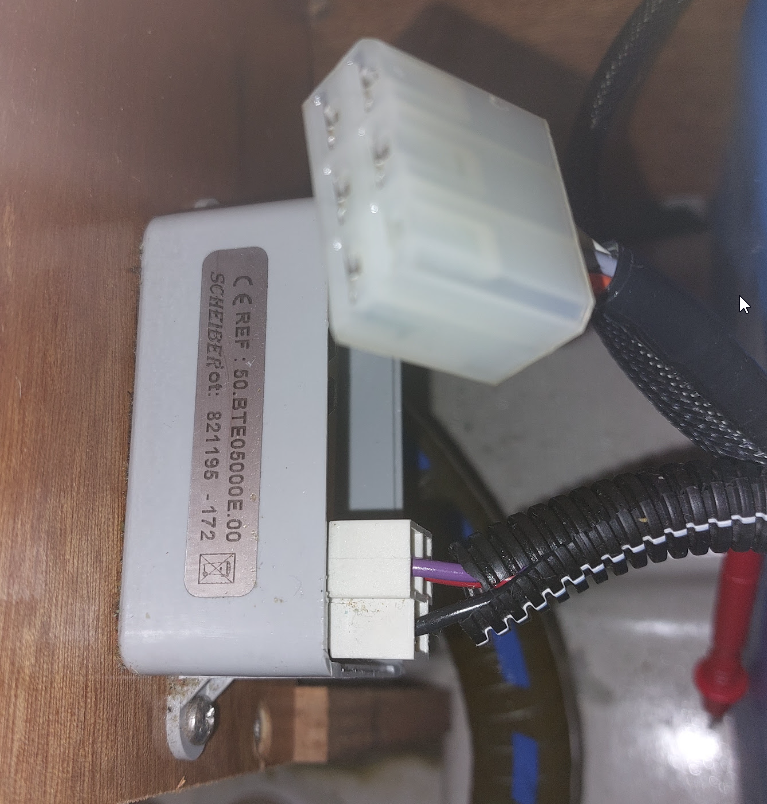

Starting today my water tank level of my Beneteau Oceanis 31 shows full even if it is empty.
Could it be due to the module? Mine is the Scheiber module (mod 821195) in the picture where I unplugged the connector to spry CRC.
Do you know how could I troubleshoot easily before unmounting the tank? :)

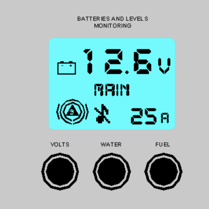

I presume the level shows on a VDO panel, a bit like this?
If so the panel doesn’t work on the resistance principles like the float switches mentioned above. There are multiple sensors inside the tank. Depending on how high the fluid is a different number of sensors are covered. The sensor module you found converts the reading from those sensors to a voltage level (0-6V) that the panel reads. So, the possibilities are:
- Something has fouled the sensors in the tank and they read water all the time
- Something may have shorted in the sensor module and it’s always returning 6V.
- Something may have gone wrong in the VDO panel itself to make it think it’s getting 6V even when it’s not.
I’d probably start by checking the connections on that module. Maybe try disconnecting it to see if the panel drops to empty (or if the panel loses track of that tank entirely). That should help narrow the problem to something on the sending or receiving end.

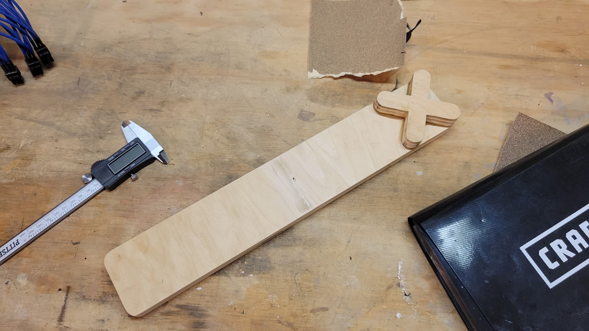

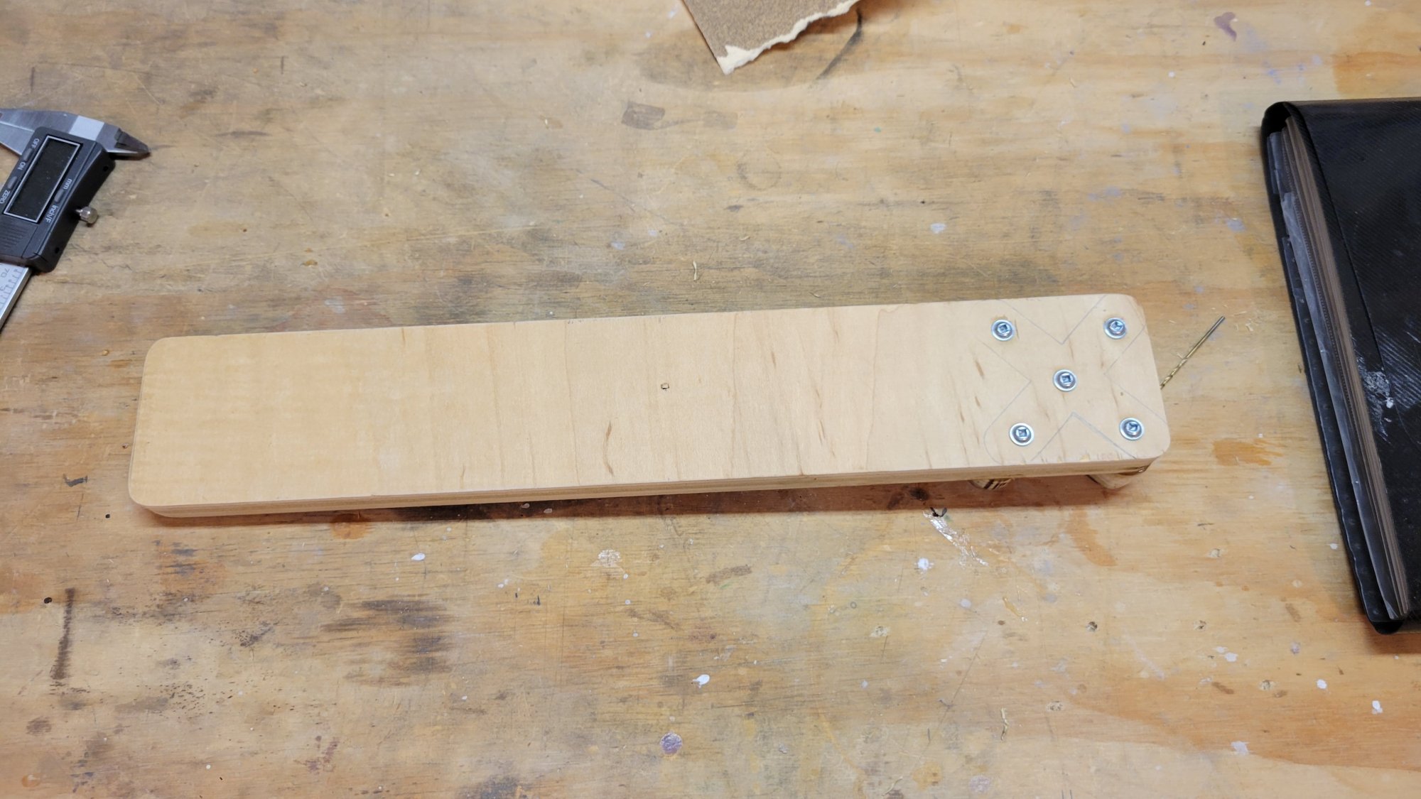

I have not been able to open the inspection cap of the tank, it was really tight and I didn't want to damage it not having a safe place where to buy a spare part. Probably I would need to build a special tool to place in the cross of it.
If I remember correctly @kodiak1120 built himself a tool to fit into the inspect port handle and help open it.
May 27, 2021
57
Beneteau 37 Chesapeake Bay
Yes I did... unfortunately, I don't have the dimensions. But just basically cut the cross piece out of plywood and epoxy/screw it on to a longer piece of plywood. Works great.
