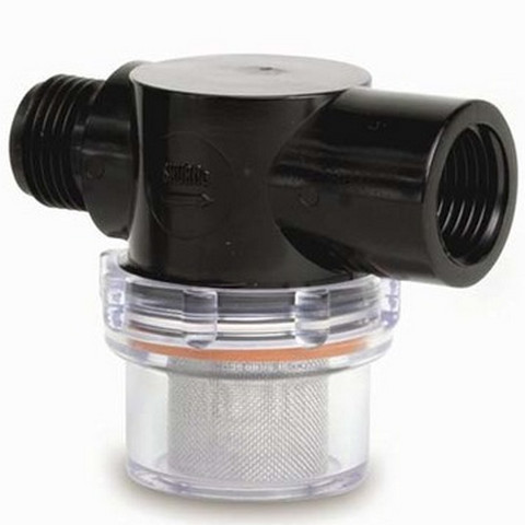

I followed Practical Sailor's advice and installed a strainer on the tank's vent hose to keep insects out.

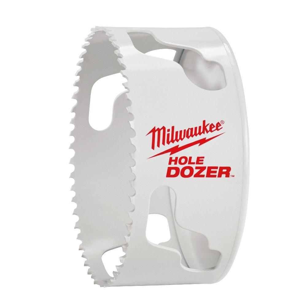

12,760
A four inch hole saw is going to run you about $25 at Lowes or Home Depot...
Then it is going to sit in your shed until you die and your kids will sell it for $0.25 at a garage sale.

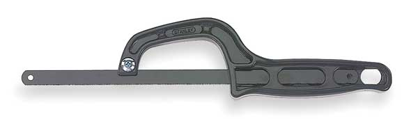

I keep one of these in my boat's took kit
It is surprising how many uses I find for it. Although the blade is a hacksaw blade, it makes an excellent coping saw for jiging out a tight pattern. And the hack part is nice for lopping off the ends of through bolts so you don't snag them and get cut. And the saw will get used again and again.

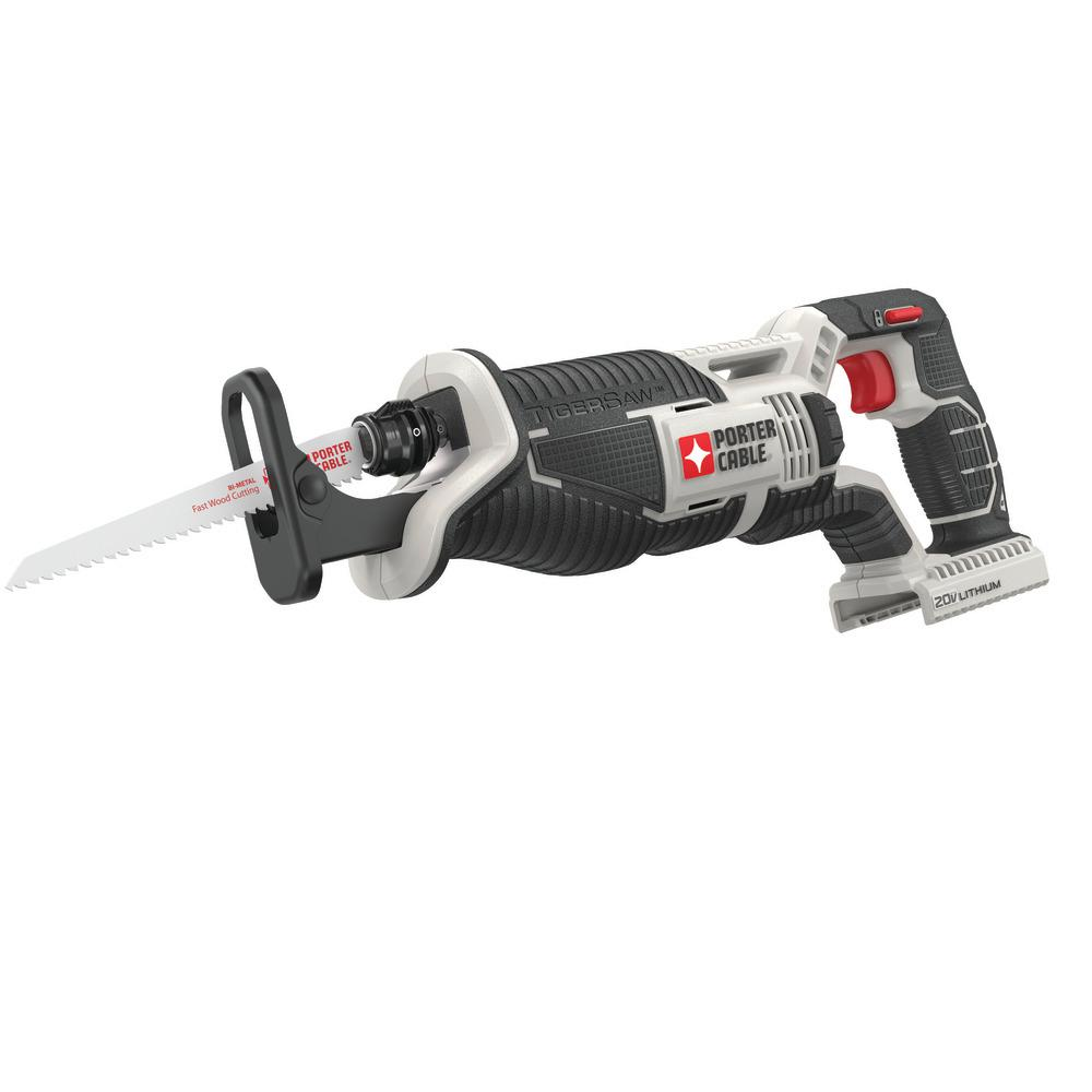

Or..
A sawzaw with a fine tooth blade would also make a nice tool for cutting that hole... again, it is something you would use again. Porter Cable makes a nice one (I have one) and it is cordless. It is twice the price of the hole saw but you will use it a lot.
