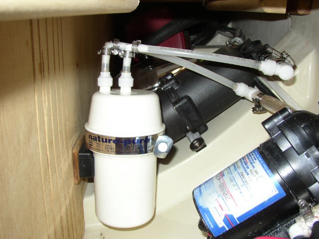

Wanting to be able to use the water tank on my 35.5, I cut into the line after the pump and inserted a filter and an accumulator tank. The filter is a Nature Pure Basic Unit which has the Ultrafine filter which is 0.1 micron. The accumulator is a Shurflo #181-203 which gives me more volume for a short period of time after turning on the water. Now all of the water in the boat is filtered before use. The picture shows the filter and the line that it is cut into. The accumulator is also visable in the background.

Pipe fittings?
The fittings on my 30T('92) are called 'quest' or something like that and look similar to what you used in the photo. Could you tell me what kind of tubing you are using and the style fittings? Some of it looks like pex tubing and some looks like reinforced vinyl. I am interested because I would like to add a small pressure tank like you did and possibly a cockpit shower in the future. Thanks

Home Depot or Lowe's
Bob: I think you will find the fittings at Home Depot or Lowe's. They also sell the stuff at RV dealers. It is actually a good system for RV's and such.
