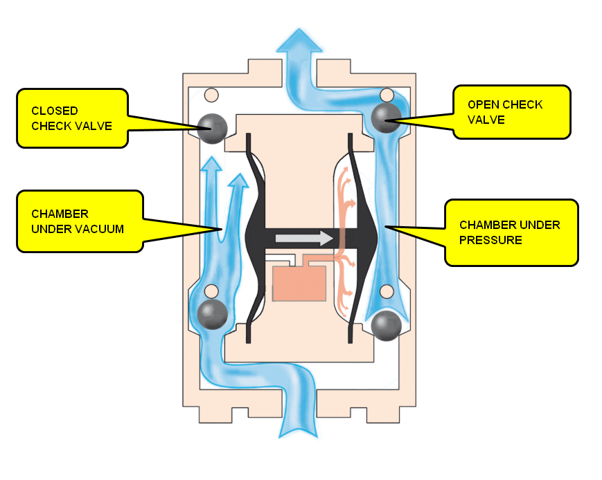

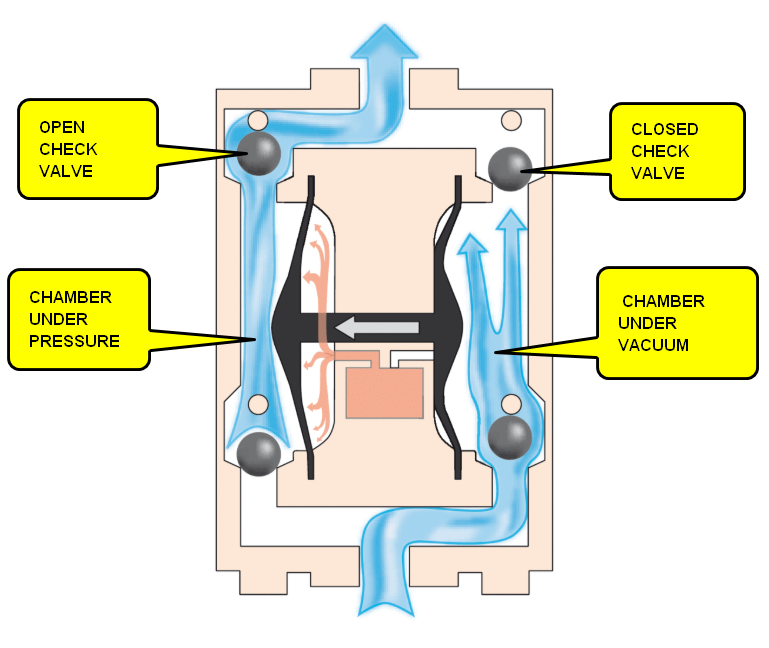

Not knowing your pump, I took a wild guess and looked at a Whale Gusher Mk3 manual galley foot pump to see how a double acting diaphragm pump works. Your pump is likely similar :
This shows the two strokes of a double acting diaphragm pump which is likely similar to your foot pump. The check valves will have light weight springs but unlikely sufficient to oppose a positive head on the suction side of the pump. Unfortunately, when your supply tank is above your faucet this pump will probably drain your storage tank. But as I said before .................. we need the make and model of your pump.

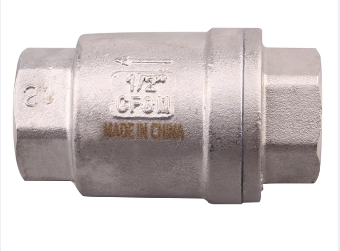

Another possible solution is a spring loaded vertical check valve :
About $20.00 for a 3/4" check valve.
Swing check valves cannot be mounted vertically. Vertical check valves rely on a spring to seat the valve disk. You would have to check the resistance of the spring. It may be enough to resist any pressure you may experience. Do NOT use metal if you drink the water as you will get a metallic taste. Use plastic spring loaded check valves for drinking water.
One (or two) of these mounted in the discharge or suction line may be enough to do the job.
