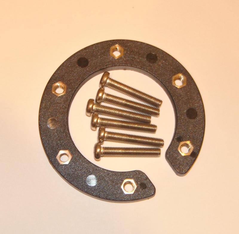

If, after taking it apart, it comes out as a simple screw on flange, you may want to look at installing something fancier with a backing ring. There, the non-sticking sealant is held solidly in place by the backing ring as the tank flexes from both filling and general flexure. The split allows for entry into the tank and a little ingenuity keeps it from falling to the bottom of the the tank while installing. The attached pic shows a small backing ring for a depth probe.
