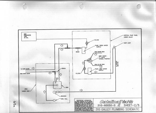

Sep 29, 2008
1,954
Catalina 310 #185 Quantico
Here is the drawing
Here is the galley plumbing drawing. The part we are concerned with are the lines labeled to/from water heater on the left.
The way the water heater is situated the aft most fitting on top would be where the intake (or to on the drawing) line connects. The most forward line, which on mine has an installed check valve already, is the return back the hot water faucets in the boat. By bypassing the two fittings with the one 3-way (?) valve on the input to the hw heater and adding a tee after the check valve for the return you can simply switch the valve to bypass and then drain your heater for the winter (and/or in parallel with draining) and winterize the rest of the system. This saves about 10-11 gallons of antifreeze and greatly simplifies the process.
I will post pictures in a day or two of the hw heater to illustrate exactly what we are talking about.
