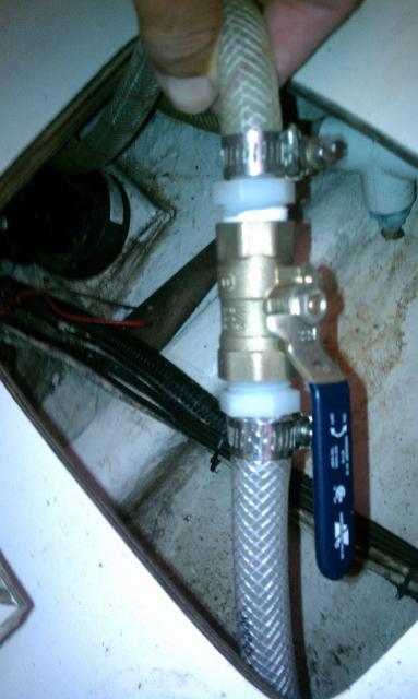

To shut off the water from the tank so I can work on the pump or strainer, I put a shutoff in the line under the pump. Simple stuff you can find at any box store. A brass valve, two hose barbs with male ends, a few hose clamps, and a piece of the hose. It lies on the floor under the trash can hole.

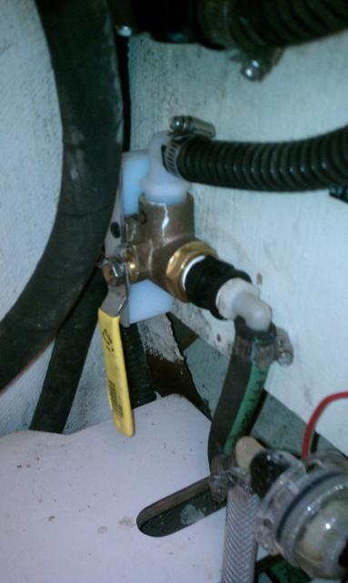

Shutoff valve and three way valve
Attached are pictures of the shutoff valve I installed for the fresh water tank. It lays on the floor under the trash can. I also removed the three way valve for the shower and frig. draining and replaced it with a brass three way vavle I bought from Defender. My wife is thrilled how much easier the new valve works.
