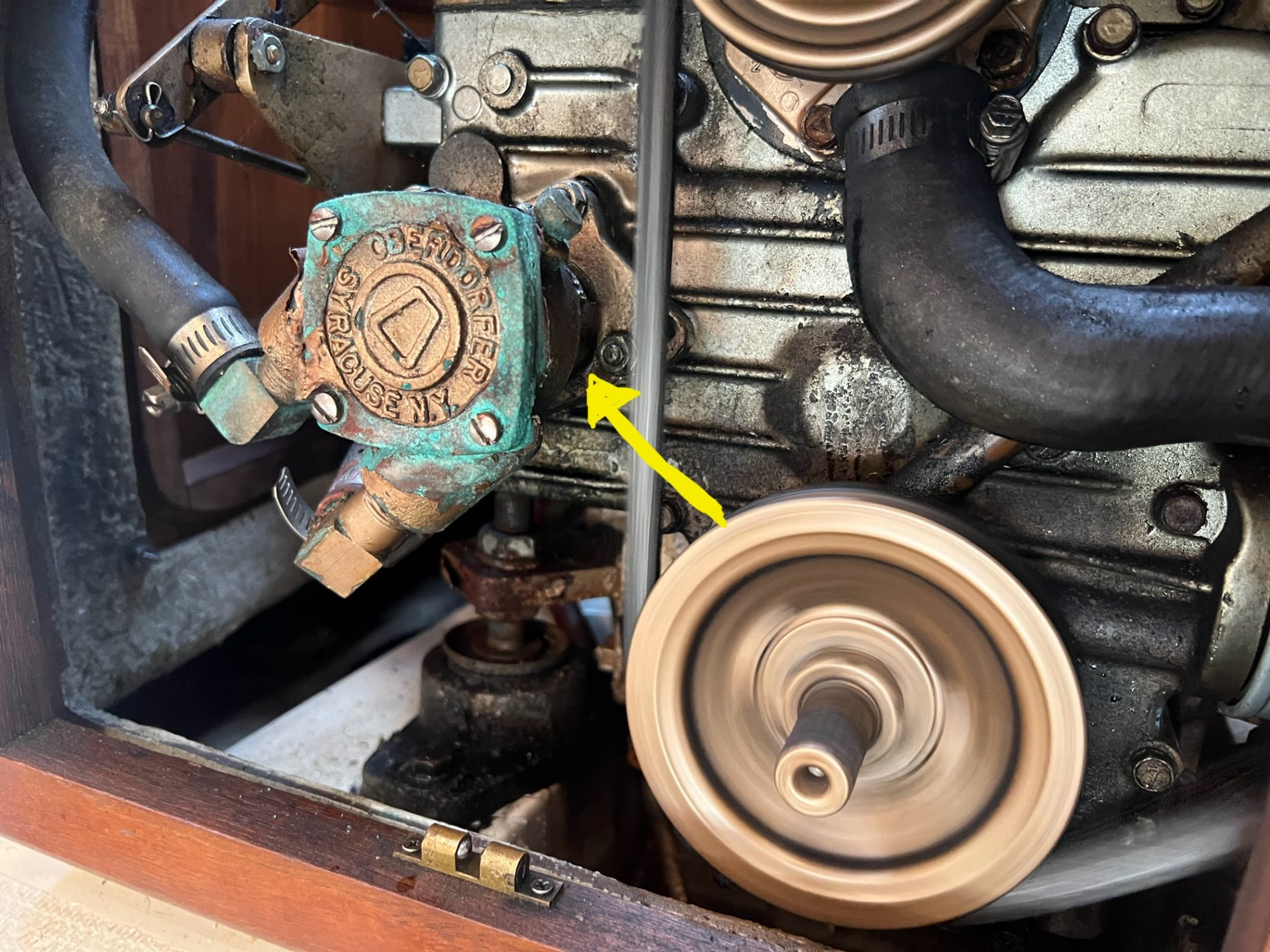

Hi all: It's always something. Just installed a new starter and feel filter/water separator, yay! Now onto the water pump, when the engine is running it is dripping one drop per second. I have uploaded an image with an arrow showing exactly where the drips are coming from. I have a oberdorfer pump which I'm sure hasn't been replaced in decades. Any recommendations as to what might be the issue and what and were to get repayments, do we think I need to buy a new pump or just the kit - Water Pump Repair Kit Oberdorfer

Yes, get the rebuild kit, pretty easy to install. As you can see, the salt water is pretty corrosive, you should try to clean up the rust and treat it with rust converter and paint. There have been cases of the oil pan rusting through - not good.

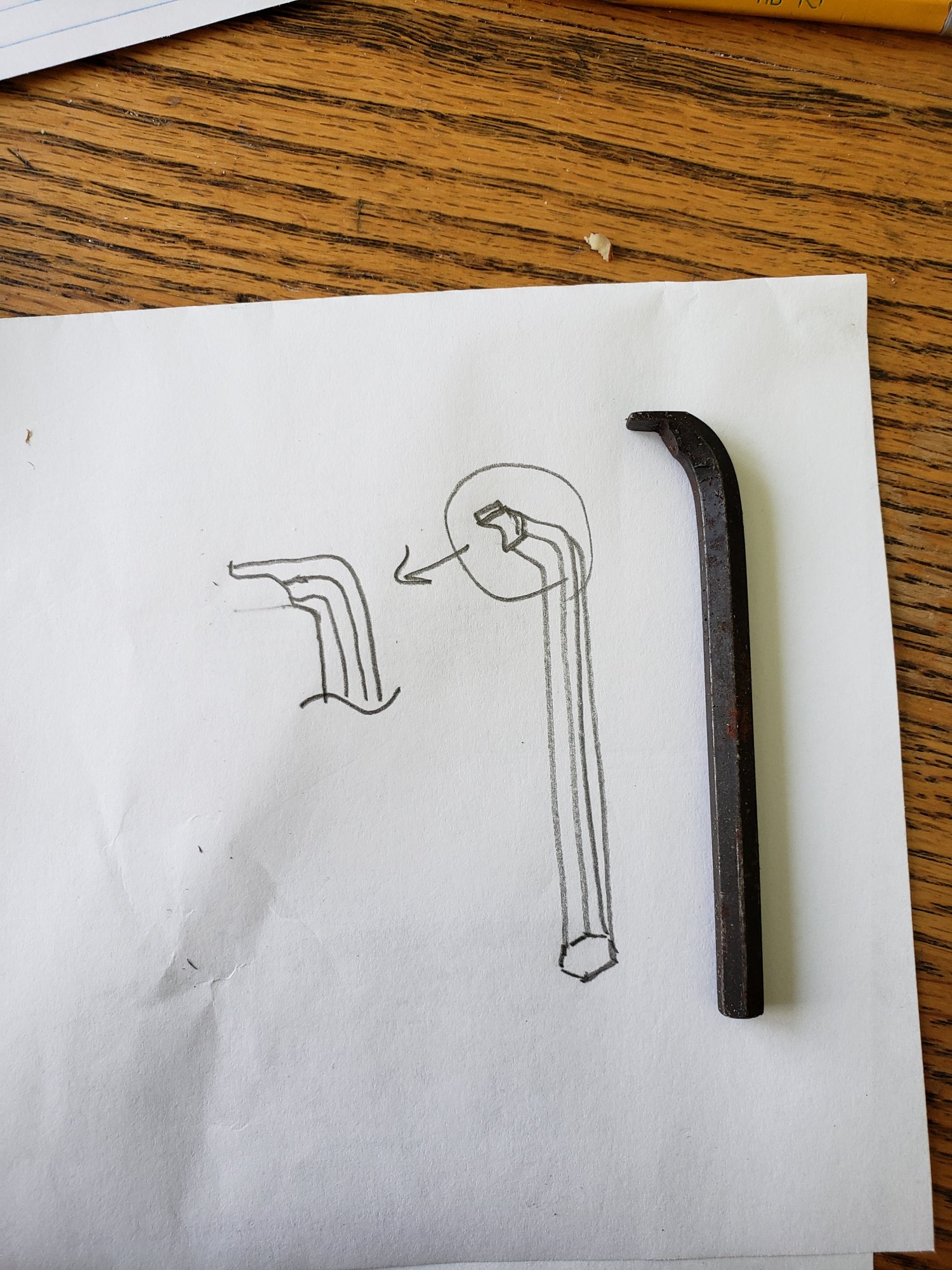

A handy tool for removing the seals I saw
online. My water pump shaft had grooves from the seal lip and needed replacement. The weep hole i think you are seeing is a space between the pump side and the engine side to keep water leakage out of your engine

I would recommend not running the engine and replacing the seals as soon as possible as the salt water may enter your engine oil and cause damage.
You can remove the raw water pump and easily replace the 2 seals. The kit comes with a new impeller.
