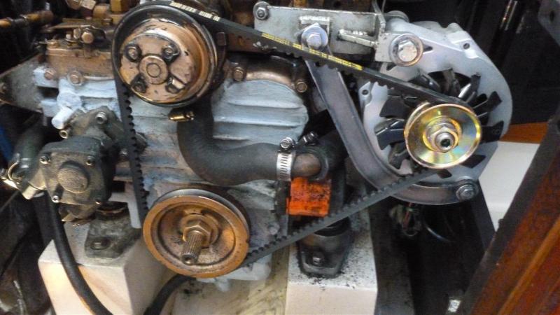

OK, let's try to clear this up.
There are two pumps on an M25. 1) the freshwater coolant pump, top center of the engine, metal impeller, on the belt, no weep holes; 2) raw water pump, starboard side, not on the belt, run from a cam inside the engine, with weep holes - is EITHER Sherwood or an Oberdorfer.

Therefore, the "fresh water Oberdorfer impeller" does not exist.
The upper center pump coolant is on the belt. Lower left is the raw water Oberdorfer.
