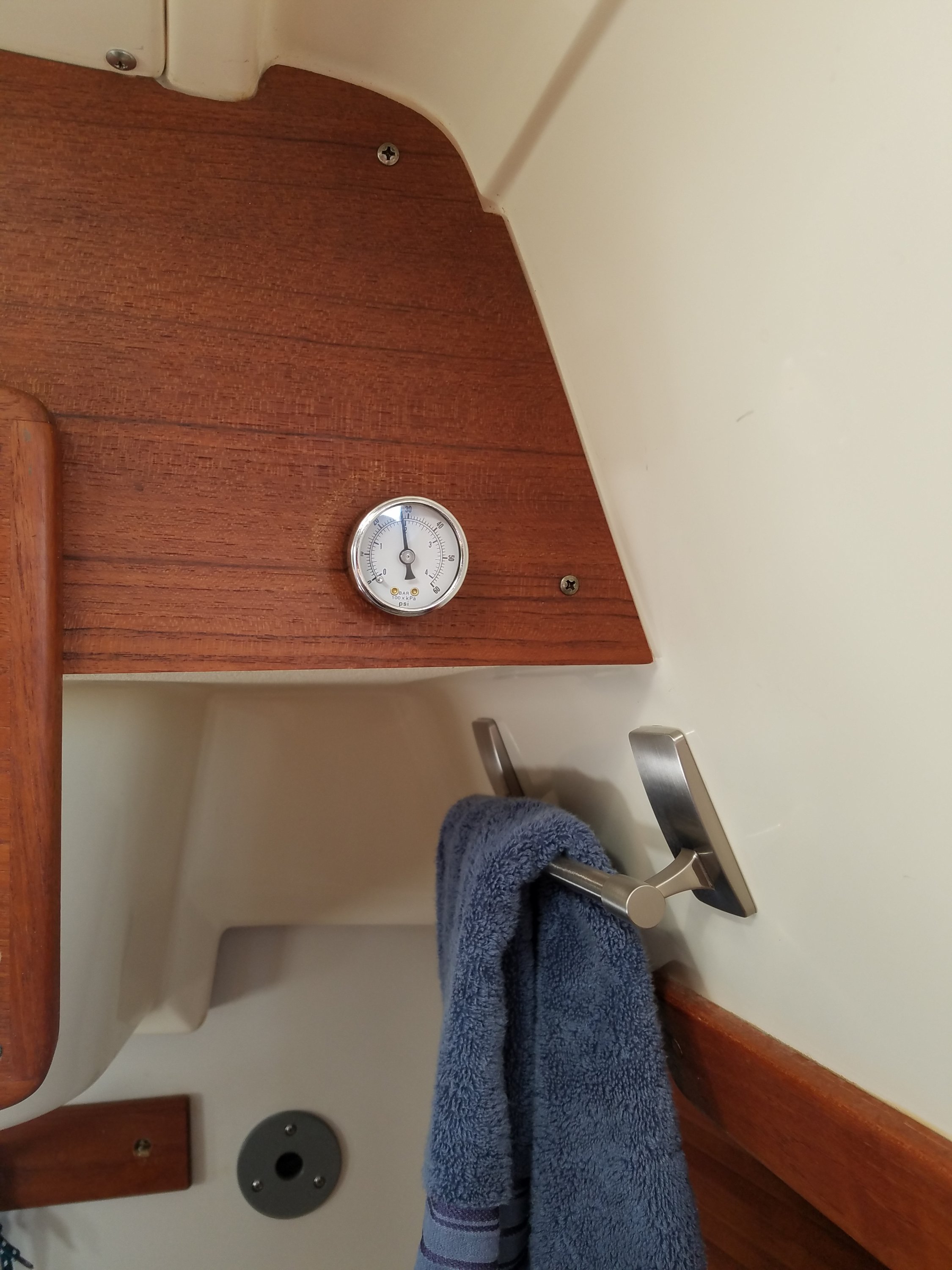

I installed a pressure gauge. ($7.45 on Amazon, 45 for the 1/8"x 1/2" brass adapter to connect to the Parker connector I had on hand.) (One thing I love about this LLDPE tubing and Parker® O Ring/Grab Ring Tube Fittings is that with only just an inexpensive tubing cutter it's very easy to cut, change, splice things together, no other tools required, and no leaks!)
So far, so good. The pump works perfectly now. The pressure is running between 10 to 12psi at the low, and 28 to 30psi at the high. It's spec'd for 20 to 40. The new pressure switch is at home ($25 on eBay), will install it next week, which is very easy to do. (It appears I could have played with a spacer in the existing switch to raise the pressure; maybe the spring is worn out. But it's not designed to be adjustable.)
