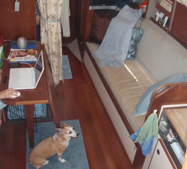

The veneer on my sole was pretty bad when I bought the boat due to this leak. In March, I sanded the veneer and wood filled a couple of places. The subfloor was solid, so I put down a Brazilian cherry hardwood engineered floor. Pretty easy to install, except the access cuts in the floor. I only had one access area (forward), and I hated that fact that I could never truly access the bilge. So I made another access that runs from the engine forward about 2.5 feet. Now I can nearly get my whole body down into that deep area -- what a difference. Even had room to install the shower sump pump in there (it would be good for wine as well, but have not figured out a way to properly store the bottles!:)).
The floor as held up exceptionally well, being that it went from Jax to Key West and back this summer with plenty of salt and fresh water on the surface and two dogs in need of a doggy-pedicure. I did glue each plank as well as the perimeter to keep out any surface water. I've attached a photo of the floor.

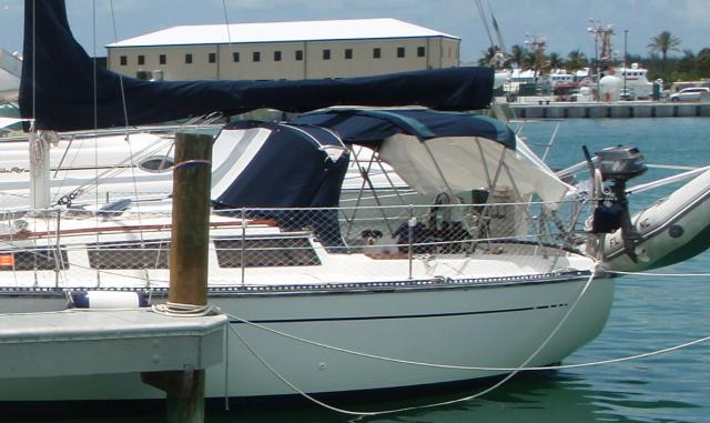

Attached is a photo of the our "invented" shade system. My wife made these about a year ago to use when we are at the dock. They zip to the back of the bimini (she's good with a sewing machine, thank goodness!). When motoring, I move the rear attachments back further using bungee cords to attach to the cross support on the davits. When I do that, I can stand right behind the wheel and have full shade, but only when motoring. Our next job is to build side panels in both screen and strataglass, but that may wait for a while...

Looks like it works to me!
Maybe I can strap an old TV antenna with two telescoping antennae to my back stay so I can pivot them down and out when needed and then fold them out of the way when I tack ;-)
Or perhaps add a fourth bar, like your middle one, that has a section I can easily fold up independent of the rest when I go to tack or have the boom centered?
A third option would be to move the traveler altogether, but I am not ready for that yet!
