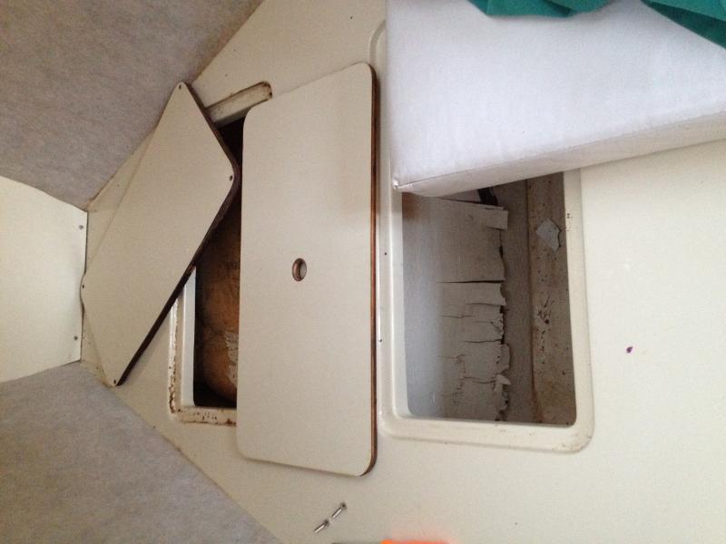

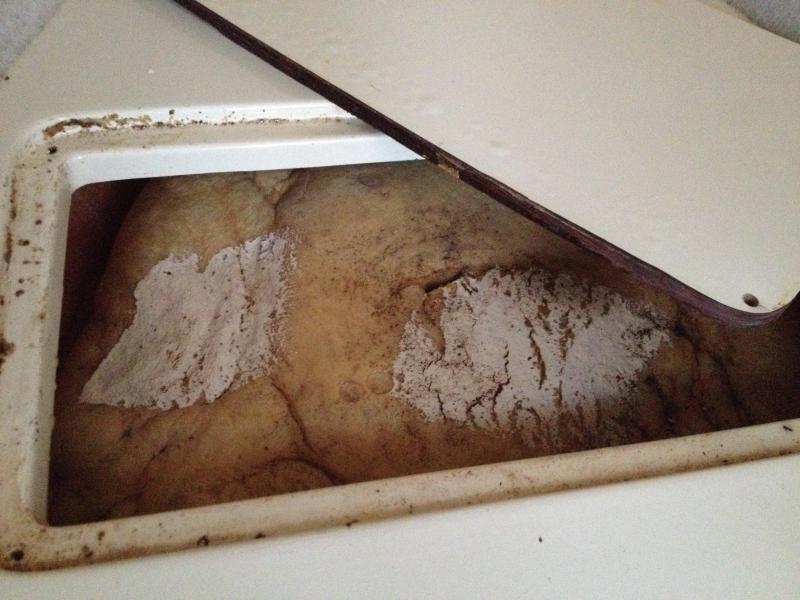

I am both new to this forum and somewhat new to sailing and owning sailboats this size. I am very comfortable sailing small daysailers like JY16s and I mostly sail on lakes. I have just purchased a 1994 Hunter 23.5 and have not actually launched or sailed it yet. I have helped crew on larger boats though and looking at how this boat is rigged I believe this is a good logical step up from the smaller boats. I will not be keeping it in a slip, but on the trailer when not in use.
Everything looks good on the boat from what I can tell except for one area. There are two compartment areas under the v-birth cushions. These are separated by what looks to be fiberglass coated wood. The front most compartment lid is made of plywood and held in place with 4 screws. The other one is a simple lift off lid. There is some moisture damage to the front most lid and to the coated wood divider. Inside the front most compartment appears to be a large hunk of spray foam and this area has obviously had moisture in it. I would like input on how to repair and how serious of a concern this is. I did not pay much for the boat and really just want to get it in good sailing shape for the day or short weekend trips on lakes in the area. I have provided a couple photos of the area of concern.
Thank you in advance for any help you can provide.
