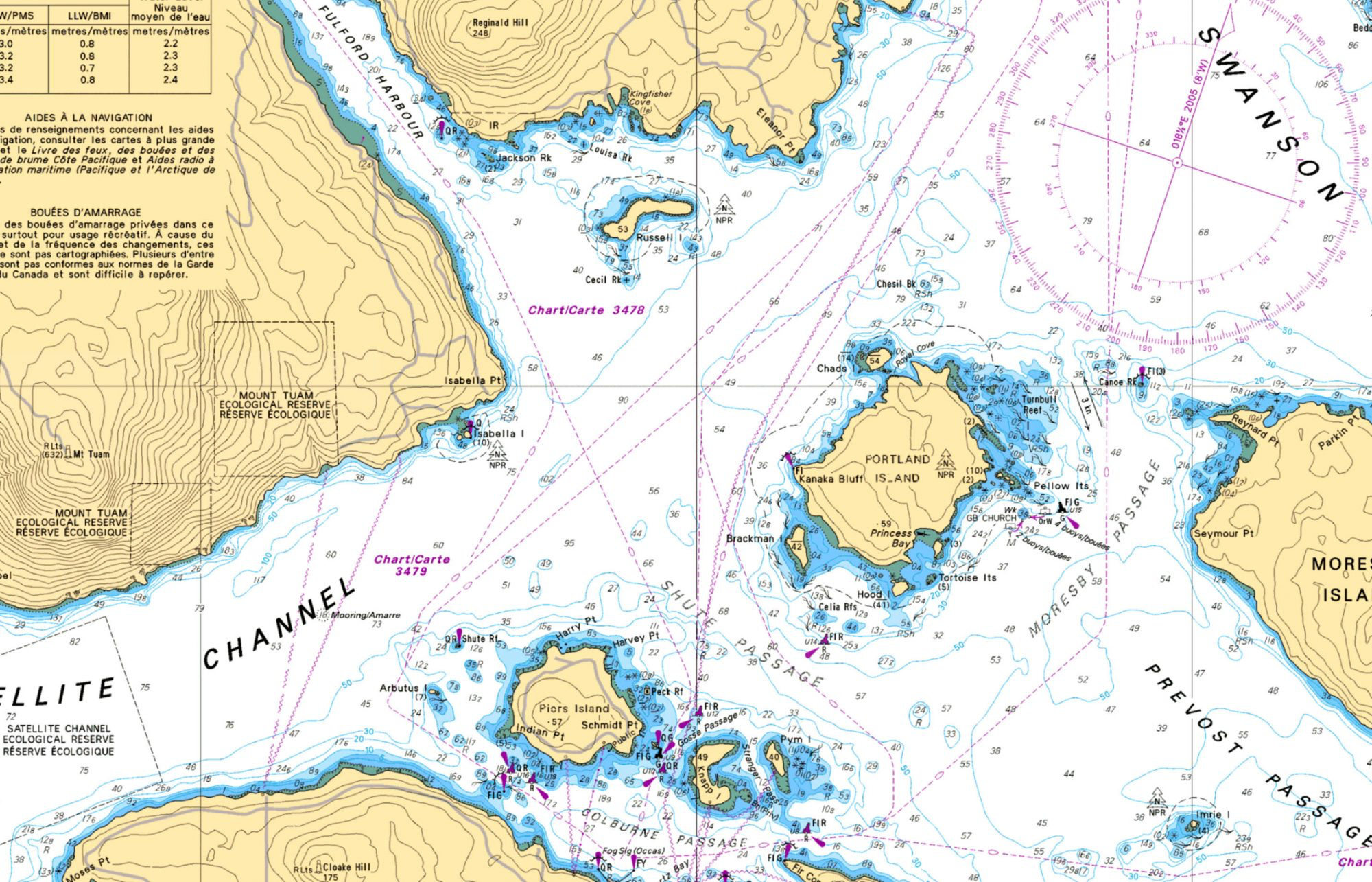

23,611
Being on Portlandor the many island,
While there is a lot of tidal flow, you are surrounded by ship traffic, be it the ferries or the many pleasure boats using the passages and channels nearby. I would think a watermaker aboard in that area would become easily contaminated. @Foswick's point is that water resources on the big islands might be a more reliable source.
That said, I was in Port Browning on Pender two weeks ago. The marina manager informed me that visiting boats could not fill their water tanks.
As you move northward, the places to stop and find water are less frequent. A water maker might be a useful tool as long as you are careful about your sourcing.
