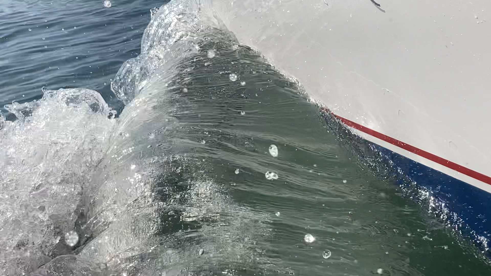

Once I was finished and had the the boot stripe back to new, I got curious as to why the forward section only was so badly worn and dull. Only way to find out was to see the boat in operation and close up from a distance of a few inches away.
This was grabbed from a video I made a few days later. It shows that the bow stays in a large bow wave while the boat cruises and accounts for the wear on the forward boot stripe over the thousands of cruising hours. Rest of the stripe was usually high and dry. Obvious when you see it on film.
