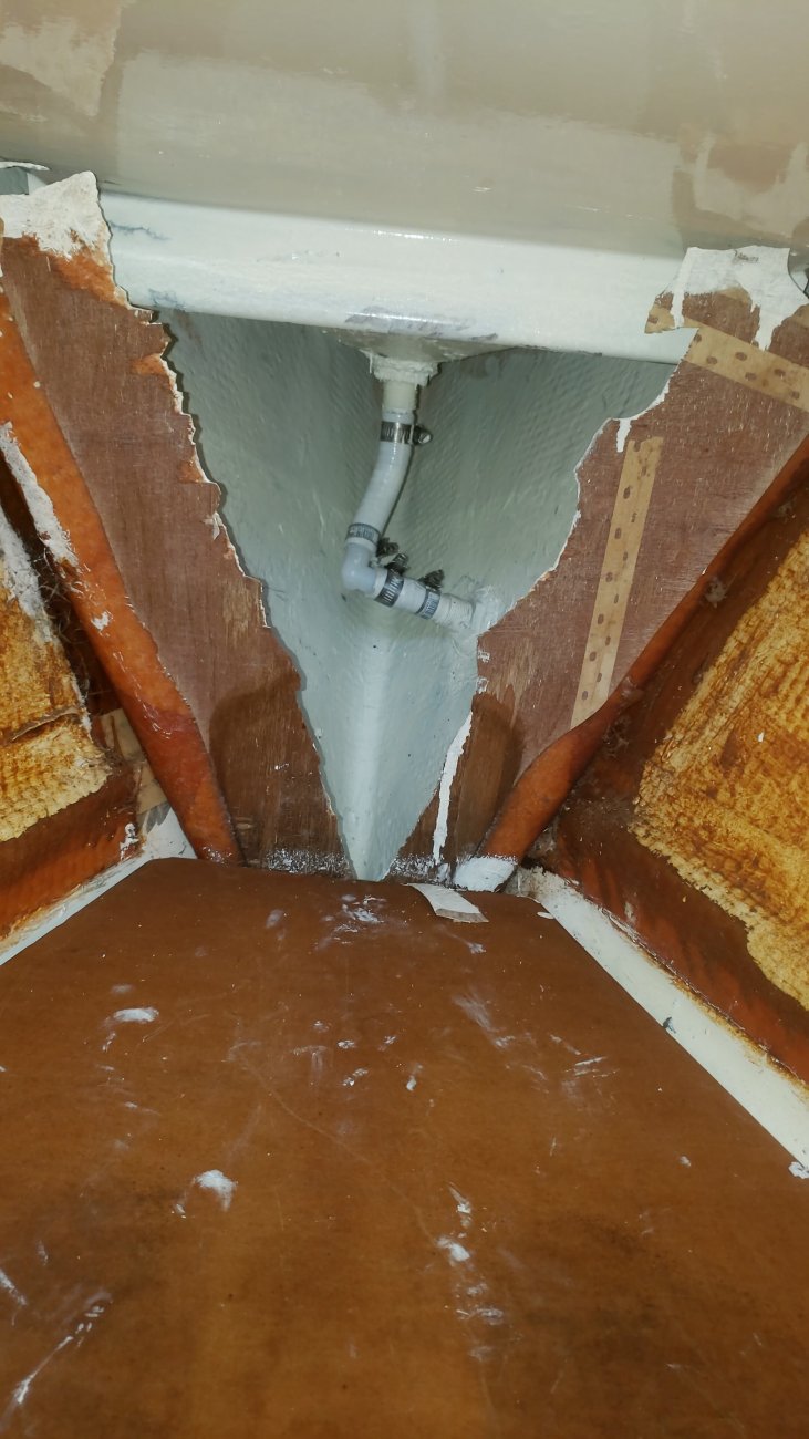

Looked under the forward berth and found 4-5 inches of water!!! I think that all the water is coming in through the anchor locker drain. Replacement parts being installed, then we'll flood the locker again and see if that is where the water is coming into the boat.
341
Hunter 34 Herrington South, MD
FOUND IT! This was the hose that drained water from the anchor locker. After 30+ years it finally cracked. The thru hulls were also replaced as the one overboard broke in my hands. The leak is much bigger now since we had a hose directly into the locker. Water would fill this compartment up to about 3 inches, and then it would seep into the area under the forward berth, and then into the bilge.

If this just drains from the anchor locker overboard, why did you leave the loop in the line? It seems this is just creating another weak point that is likely to leak in another 30 years.
341
It looked like the original had a loop, but you guys are right, I'll take it out.
23,808
I can understand that you see the need for a right angle. Issue is you used a 90 degree right angle. This type of right angle restricts the flow of water. If you happen to get a shell off the deck into the drain hose it stand a good chance of catching in the right angle and blocking the drain.
Your need a fitting with a radius more like this.
Or differently tubing that allows you to have free flow.
