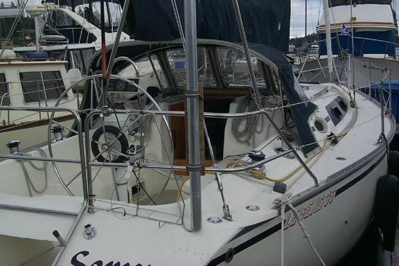

Given the terrible weather we have been experiencing over the last few weeks here in the UK and following a long hard bash into a F6-7 lumpy, steep and sometimes breaking 10-12ft swell with spry contstantly flying over the whole of the boat (thank god for the spray hood)and some serious nose burying, I noticed when I finally got back to berth (around 2am) that there was a considerable amount of water ingress into the cabin. I have been trying unsuccessfully for a number of months now to track down an irrating leak that manifests itself by water dripping from the headliner onto the starboard shelf directly in front of the chart table. I had suspected the mast for a long time but all my inspections had revealed nothing. Owing to time constraints I had to leave the boat the following morning after having cleared up the water and re-stowed the various bits and pieces that had come adrift during the 14 hour pounding. I did however place a medium sized pot under the leaking area and funneled the water to it with a small piece of plastic placed between the headliner and hull. The next weekend when I got down to the boat the pot was overflowing and there was also water dripping through the mast/compression post cover which confirmed my suspicions. I removed the cover and was pretty shocked to see that I could see daylight. What it looks like has happened over the years is that the 2 rear fixing screws that secure the mast baseplate had sawed from side to side thereby elongating the holes (rather neatly I might add) and the water was flowing in through them. (I had previously suspected the through hull where the mast cables enter the cabin). On removing these two self tapping screws I noticed that the starboard one was nearly smooth from the sawing action. Has anyone else experienced this and if not I would suggest you check to make sure. Hope to have it all fixed soon. Happy Xmas and sailing all
