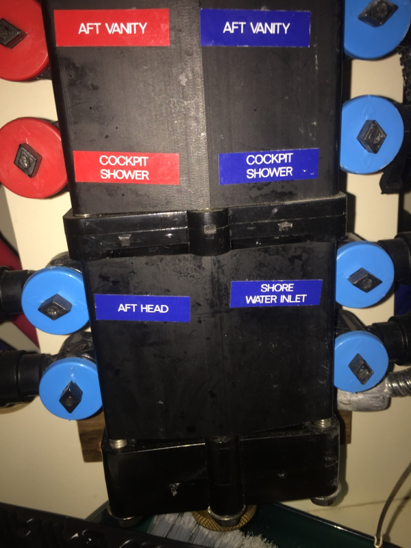

I have the same boat with an electric head in the aft washroom. I was having the same problems and suspect it is probably the solenoid. If yours are fresh water flush (like mine) easiest temporary fix when leaving the boat unattended for some time is to just close the outlet to the head at the manifold under the sink.

The toilet is a Jabsco Model 37045-Series, using onboard pressurized fresh water. I'm sure it is the original toilet installed in the boat by Hunter ... the boat is a 2005 Hunter 41DS. From various comments as well as studying the current Operator's Manual, it appears that the problem is in the solenoid valve. Someone mentioned a gate valve to cutoff the fresh water from the valve. I see the bunch of stuff under the sink but I haven't figured out what is what yet.

That did it! Thank you. Now the water input to the toilet is off and we don't need to keeping turning off the water pump breaker. I don't know why I didn't think of that. Thanks again. Now we'll have to get it repaired.
