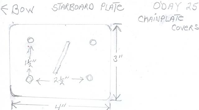

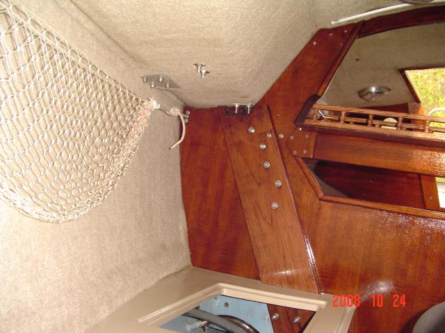

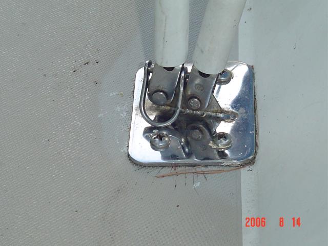

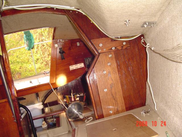

Like the man said, the easiest way out of it is to re-caulk it, but I ran into the same problems on my 1986 O'Day 222 when I replaced the chain plates on my boat with O'Day 25 chain plates. What I did was have a marine fabricator make up some stainless steel covers to go over my chain plates, and he welded them in place. Each plate has four bolts that go through the deck, along with backup plates on the inside. I had beefed up my bulkhead with oak boards which are in turn bolted to the settees on both sides of the cabin. Having the needed clearance for the nuts, bolts, and back up plates in the V birth section of the bulkhead has to be taken into consideration. I have stronger chain plates on my boat now, and no more leaks. I would try re caulking the chain plates and avoid using any type of hull cleaners on your deck that can eat out caulking. Some household cleansers contain Oxalic Acid that will eat out caulking. I learned this the hard way years ago when I had to remove my rub rail and re caulk it. Now I use soap and water on my deck and nothing else.
