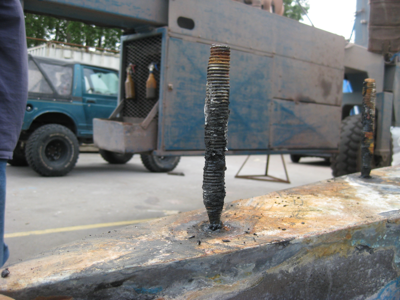

The problem with the keel joint leaking is that the keel bolts are then exposed to water which may become oxygen starved and cause corrosion of the bolts. Boats from that era typically have 304 Stainless keel bolts, not as corrosion-resistant as the preferred 316 Stainless. On most boats, either the bolts or the adhesive will keep the keel attached to the boat by themselves but you want both of them to be intact. Determine if the original adhesive/sealant in the keel is breaking down or is still in good shape and just has a couple of voids. The only true fix is to drop the keel, examine the bolts and re-do the bedding as Terry says. If you think the bolts and bedding are Ok, you can do what Kloudie1 suggest, digging as deep into the joint as you can.
Here is an example of what can happen to your keel bolts when exposed to water:
10,536
