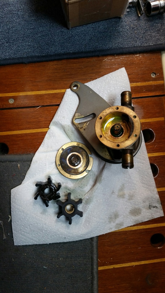

Justin... at the water pump use the proper sized "Full Flow 90 Elbow Pipe to Hose Fitting"
You'll have no flow restriction and no kinking.

this is a pic of the pump when I had it off for maintenance. I'm not sure if the fitting is replaceable. Good thing I'm starting this project early!

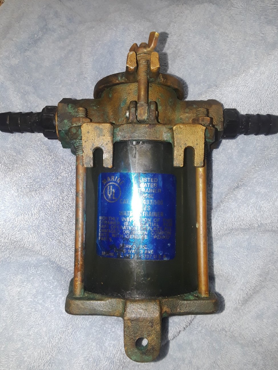

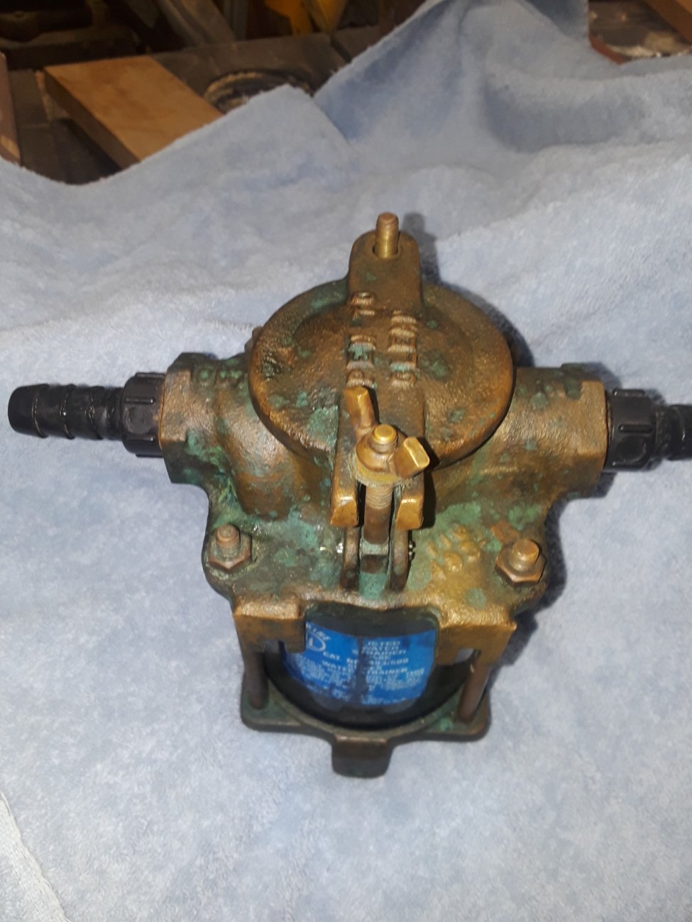

First glitch in my Perko water strainer project. My pain may be your gain: I ordered my gasket set before I dismantled my strainer. Vinegar seems to work pretty well as a cleaner BTW. Anyway, the black gaskets that I assumed were rubber, are really cork. I asked Perko if it made a difference which materials to use. They say the (older) 493 used cork and must be replaced with same. the newer 493 uses rubber. Figures. I had a 50/50 chance to get it right and I blew it. So now I need to exchange my set with a different one. Shipping is almost as much as the parts cost!

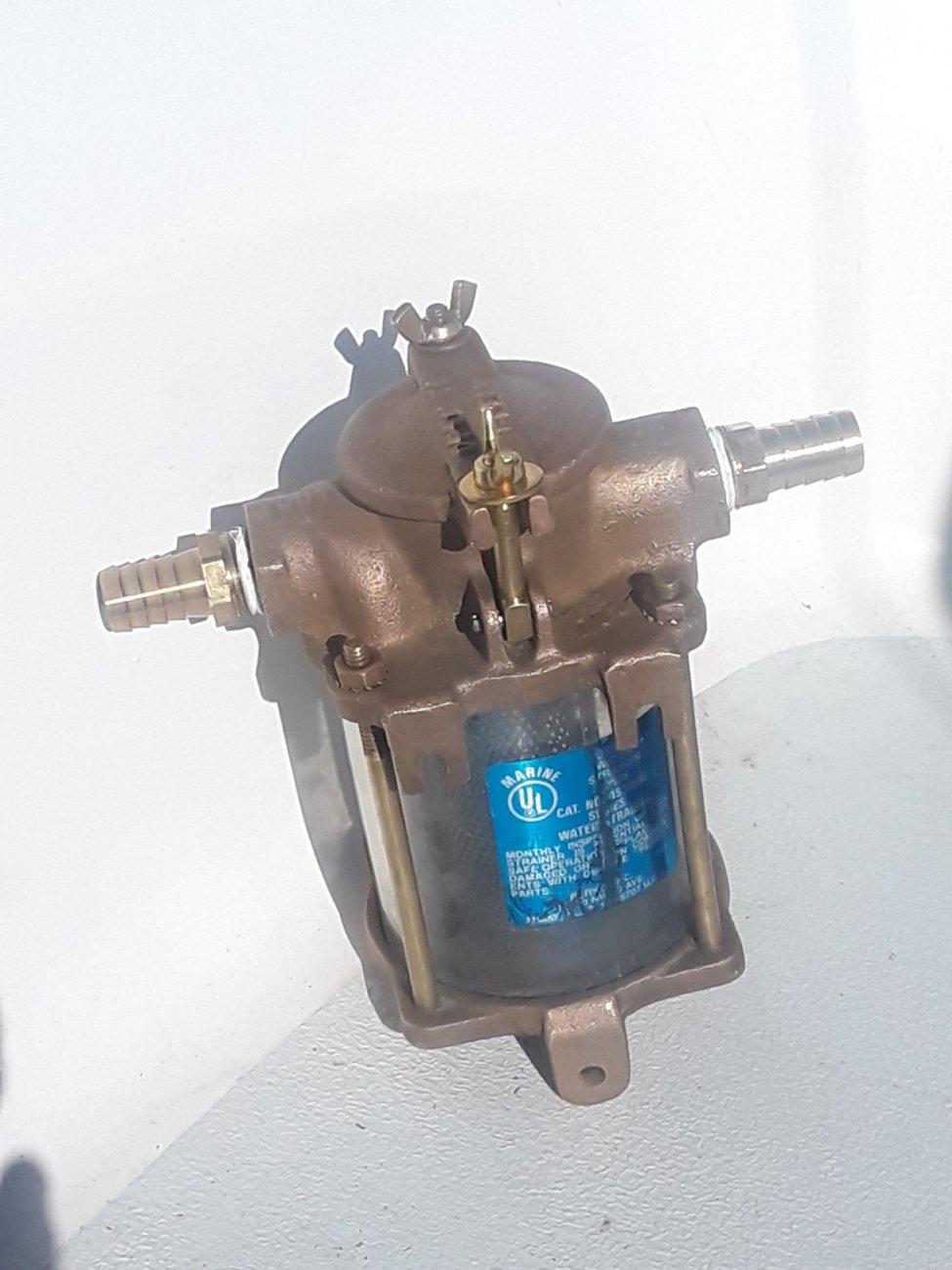

Project complete -
I haven't found 5'8" wire-wound hose in bulk yet. I would need 5'. I had enough excess to clip the ends off and reinstall. I wire brushed the patina off, replaced one stripped pivot bolt and the 3 cork gaskets. Replaced the in/out plastic fittings with brass. Carefully and evenly tightened the 4 assembly rods. Reinstalled it yesterday. Next is the Racor filter plug washers.
23,179
Boy that looks clean and ready for service.
Nice job.
