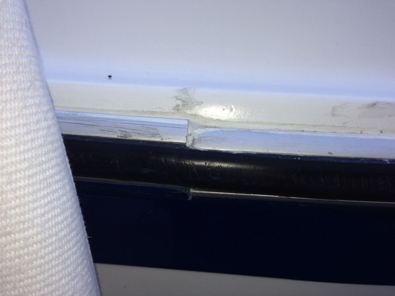

Hi, i have water coming in from side bumper. I tried to used silicon however it does not stick to the rubber. Each time it rain I'll get water in. I also tried to remove a small portion of the rubber but putting it back was a challenge.
It is on a Venture 25 1976. Any ideas wi be good!
Thanks for your support.

I did not put enough details sorry. It is the protective bumper on the side if the boat. I do not know how to call it.
I know it is from there because I used a garden hose and open the water in one spot only. Inside I could see a drift of water coming in.
I do not have access to the screws since they are under the side bumper and I can easily take it off but very hard to put back.

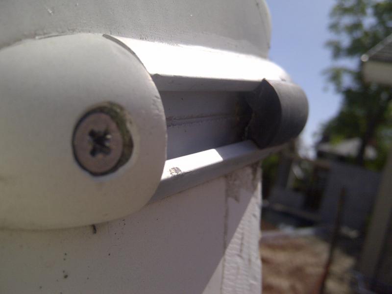

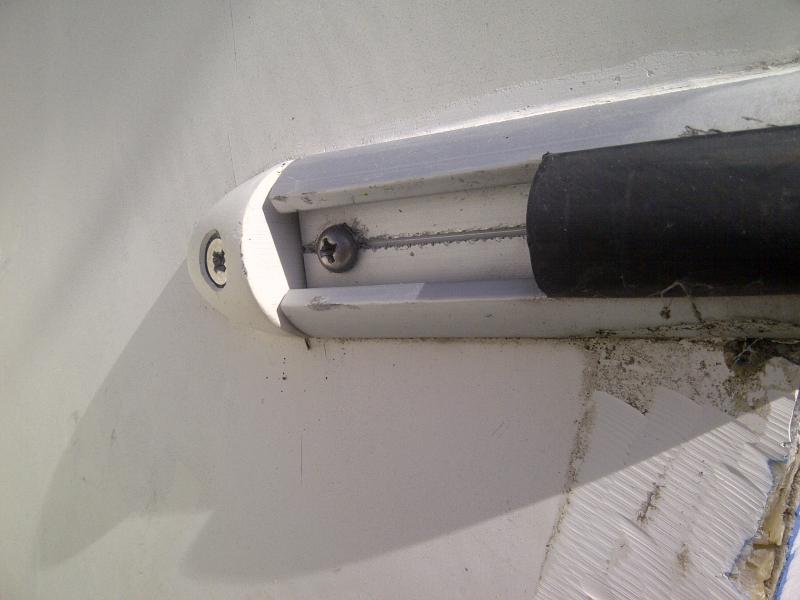

If your rub rail is like this the water is probably coming in from behind the aluminium and seeping through the bolt holes.
My solution is to clean the hull and rub rail joint and apply some type of silicone or sealant.

Hi everyone, I just want to close on hat I did to fix my issue.
I was able to remove the bumber quite easly and used butyl tape over all the screws' head. I also filled with butyl the join between the 2 rails.
to put back the bumper I had to used a heat gun and a flat screw driver. it work very well and resolved the water infiltration problem!
