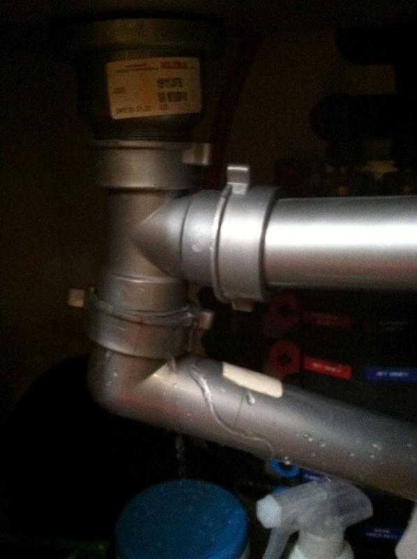

I have the same boat with a similar if not same problem. turned ut to be sink connections draining small amt of h20.
Fresh water leak:
I repaired a galley sink discharge leak. The plastic plumbing and hoses connected underneath the sink were torqued and causing the twist-cap connections to become loose.
Iwill send a pic
