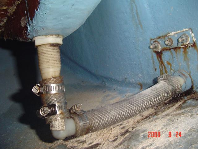

The problem I have with my self bailing system is that they installed a thru-hull fitting in that small well that is too long. If it was shorter, I could have gotten away with a single piece of reinforced plastic hose.
Check out the pic. Look at all the treads on that thru-hull fitting. Maybe I could remove it, cut it shorter and grind the threads off so that the hose can fit on it. Then a piece of plastic hose could be bent on to both thru-hulls without kinking it. What do you think?

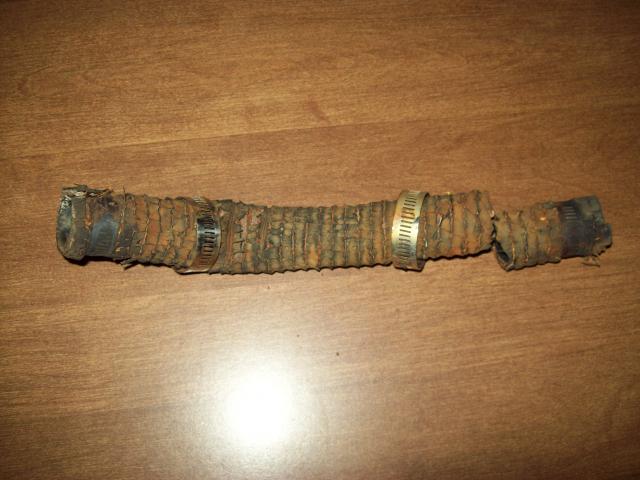

We sailed her last weekend and that prompted this thread. We had nice weather today so off to the lake we went. There was a TON of water under the port seat. Luckily my lazy gene kicked in and we arrived at the marina with a brand new (and quite small) 12v bilge pump. It had the water pumped out in short order and off we went. I checked after we had been out for a while and the water was back!! Ahhhh!!
When we got back to the dock I started poking around. Looking under the stern at the area Joe posted I found the culprit. Instead of a nice, neat orderly piping setup that is in the picture, an old radiator looking piece of hose poorly installed and leaking. I managed to 'adjust' the piece of junk to put the breech on the high side of the thruhull on the stern. After another round with my new little Tsunami pump, a temporary relocation of the two batteries, and a verification of no new water entering, we left it until the fix on Saturday. So hopefully with a small chunk of 1" pipe, perhaps an elbow, and some good hose clamps, we'll be back to the dry side of sailing.

I just went thorugh the same thing on an Oday 28. Starboard side self bailing cockpit hose cut in 3 places. Boat was taking in a fair bit of water during rains. Trip to West Marine and 10 minutes of work and I am back in business. I may do the "good" side also to avoid future aggravation. No Oday is a spring chicken anymore.

Mine wasn't cut until I couldn't get it out. There was a big hole in it prior to my intervention. This thing is in a tough place to work so making one hose two was a big time, and mostly aggravation, saver.
