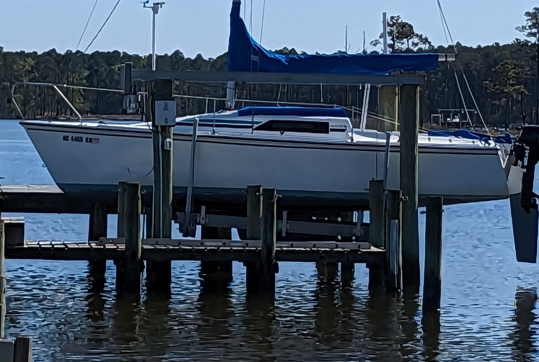

I have an 87 Hunter 23 that I keep on a lift in Eastern NC. After Hurricane Ophelia I found that I had water in all three "bilge" areas in main cabin. I vacuumed at least 5 or 6 gallons of water out of these areas. I also noticed that the wood bulkhead under the v-berth was wet at the bottom along the floor. I inspected the access under the v-berth and it was dry. The water did not come in from above the floor. All cushions, bulkheads and ceiling are dry. This happened after one other storm. Where is the water coming from? I assume it is being blown in somewhere. Any ideas? I get no water intrusion while sailing.

Photo of your boat sitting on the lift please.

Your description left questions for me. You may very well have a 23 wing keel that may have come from my dealership due to location plus the amount of those boats I sold
