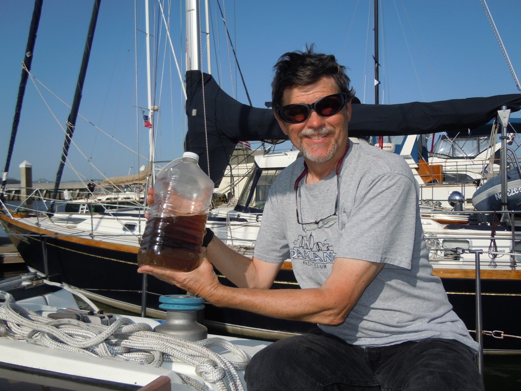

Critters growing in the water diesel interface.
23,790
@hunter healer :worthless:
So here you go.
Diesel is usually tinted a color so that it can be identified as taxable or not.

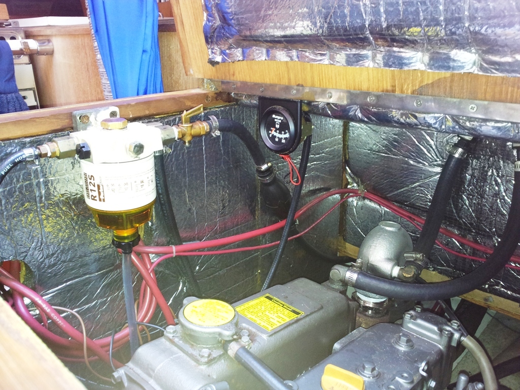

Nice engine bay on that picture.
I think you have to connect the vacuum gauge on the output side of the Racor. You will never measure any difference in pressure on the input side if the filter gets clogged. For this reasoning I assume that the pump is on the engine side of the Racor and pulls the fuel through the Racor. If the filter gets clogged the pump has to work harder to get the fuel through the Racor and this shows as an increased vacuum on the gauge.
Good call senang. I had to check my picture and the instruction sheet of my Racor. I did hook the vacuum gauge to the second output of the filter. I misspoke on that one. Thanks.

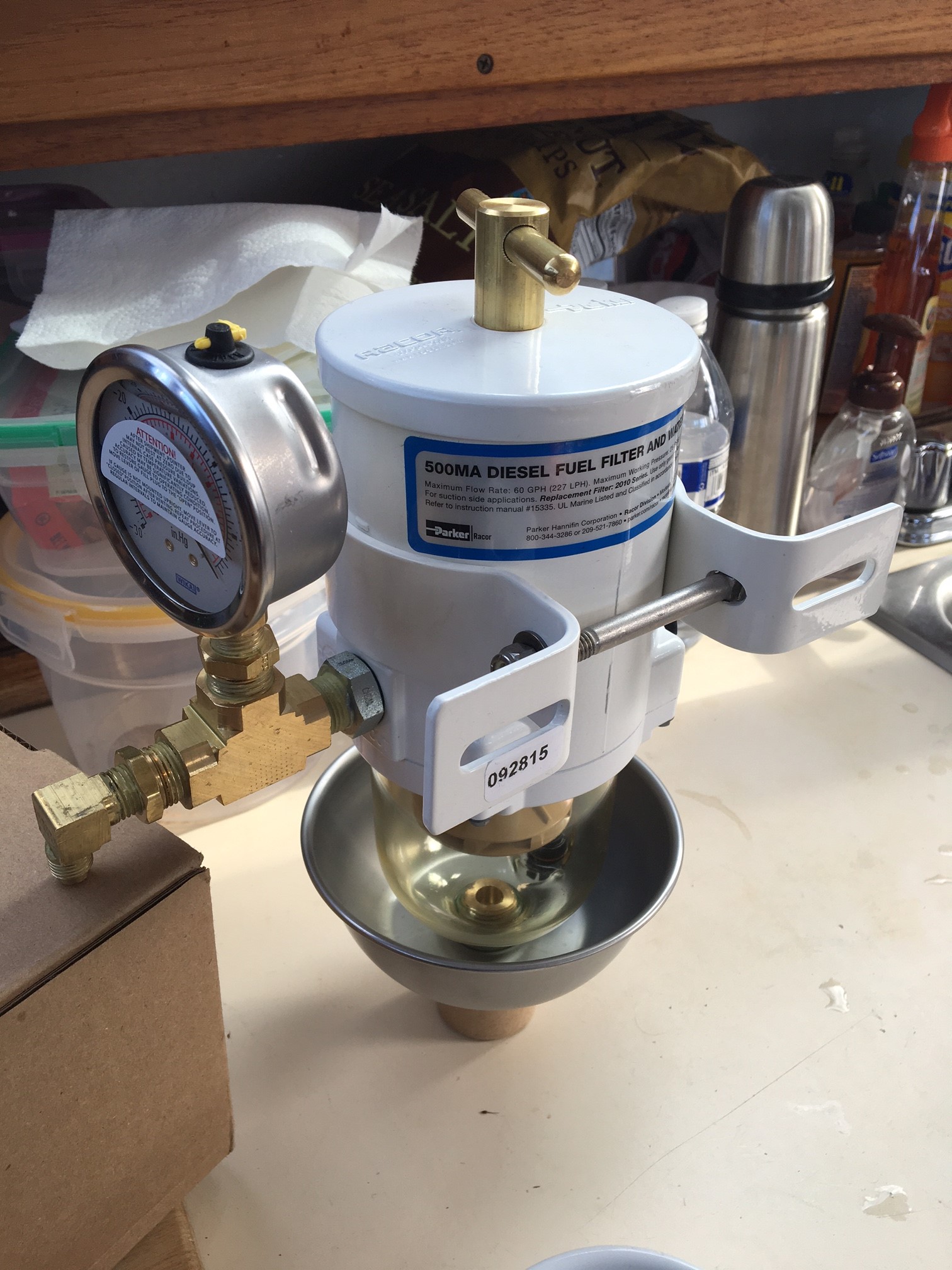

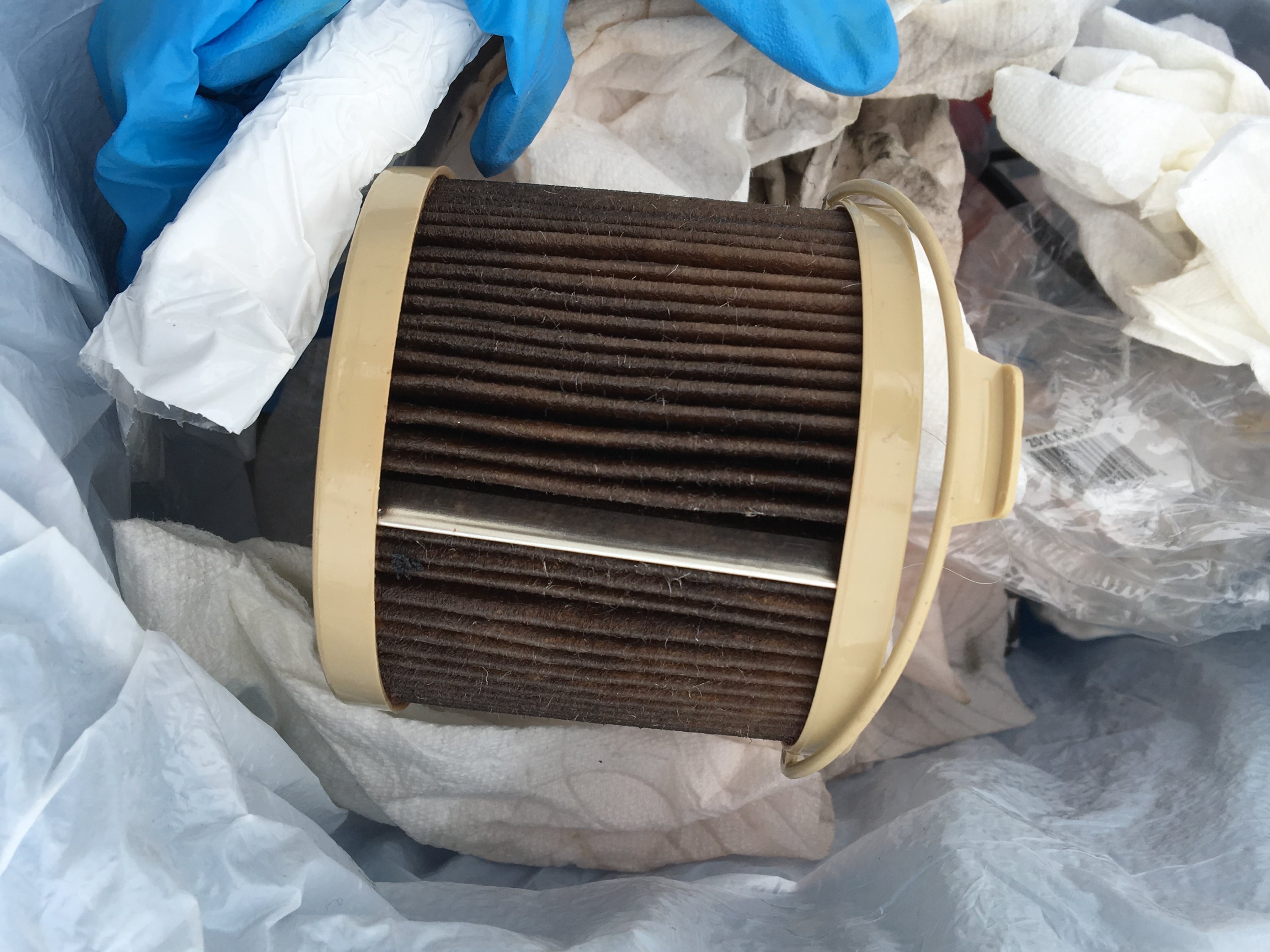

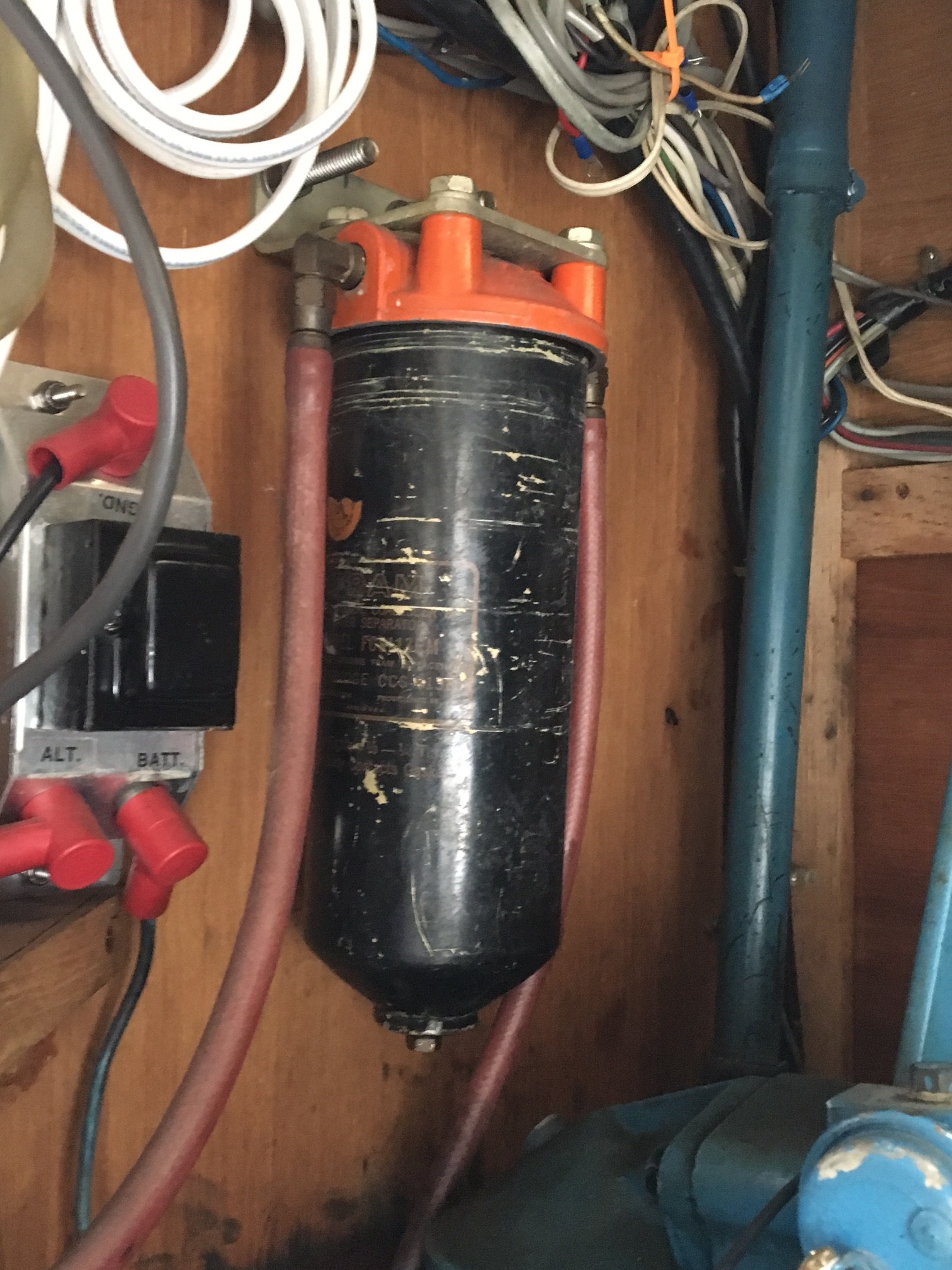

(I needed to replace the original Ford truck filter anyway, FilterOld.jpg but I threw it in to the cost estimate at $210) and chemicals.
