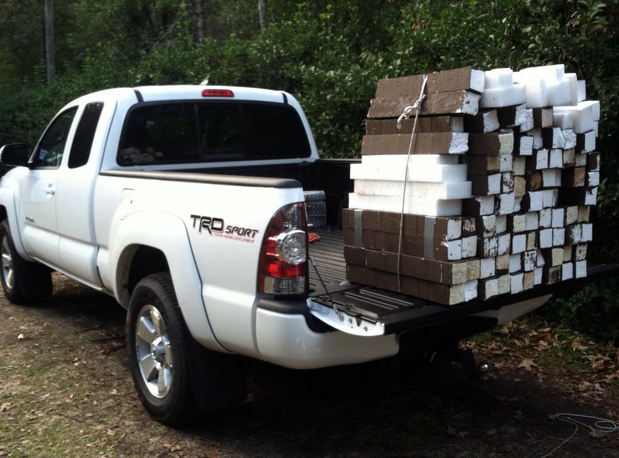

I've never been a fan of user-installed foam, for a long list of reasons. I'm told Catalina offered factory foam (which yours might be) but there have been many threads here about it getting waterlogged, and how to remove it.
This was what I removed from Daydream when we first brought her home. The pieces were tightly packed into various compartments, with the covers screwed down:
And that looks a lot like the 1.34m³ from my calculation :eek:
