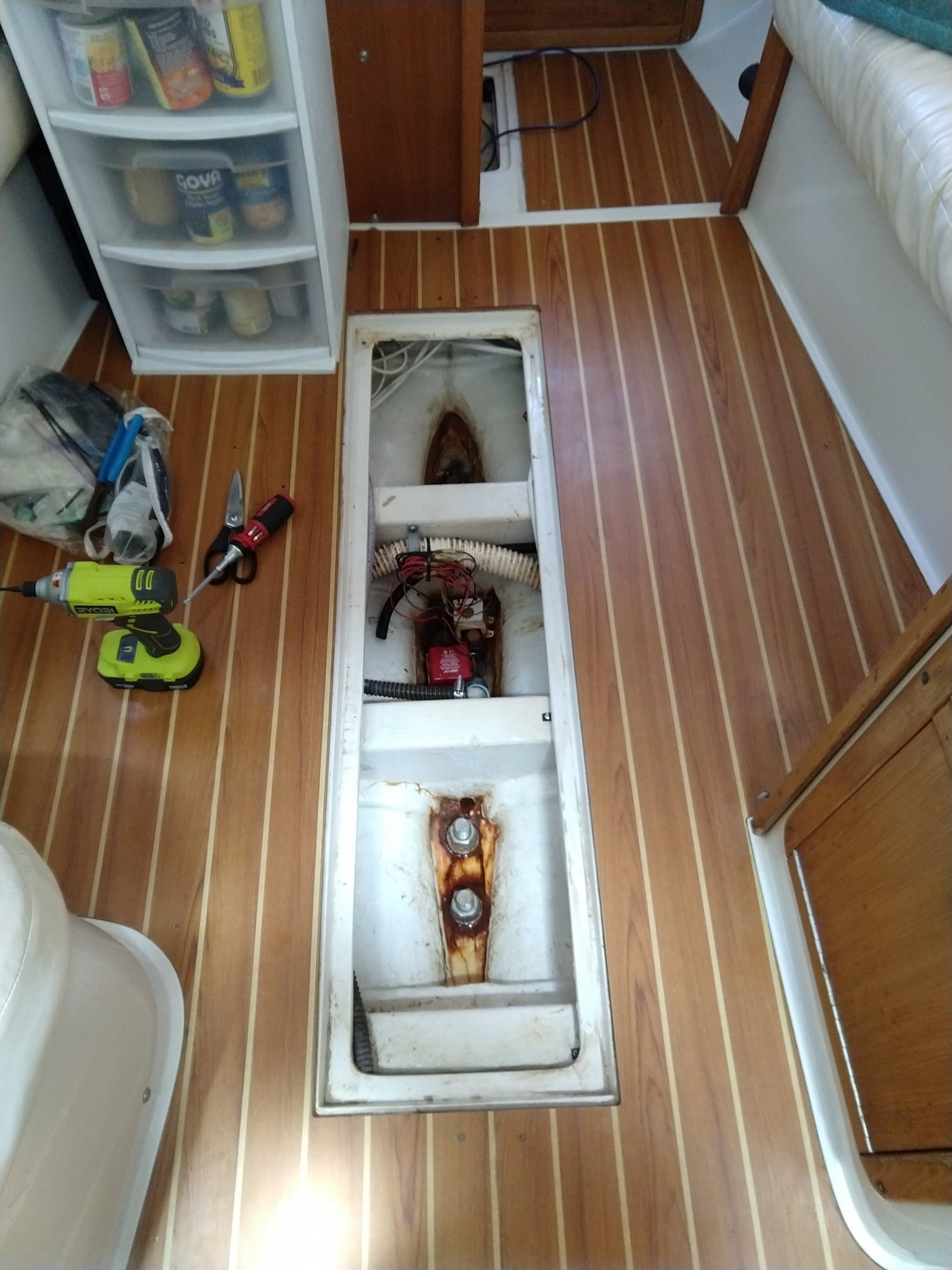

The three white boxes that run the width of the boat are the stringers.
