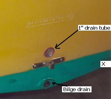

I recently purchased an O'Day DaysailerII. Upon removing the bilge inspection overs I noticed a fair amount of water in the bilge. When I removed the bilge drain plug nothing came out. I didn't really notice any debris in the drain hole that would prevent the water from coming out. I probed around with a wire also. Des the water drain from the sides of the drain port or top? I noticed what looked like a plastic "plug" or fitting a few inches in the drain hole ? Any thoughts ??

The drainplug in the bilge is a bit of a mystery as to just how the water is supposed to get to it! Some DS IIs had the drain located off-center, this might ahe "solved" the problem? Anyway..... the drain does seem to take water in sort-of to each side of the hole, I think the direct path from bilge to drain is semi blocked by the "catch-basin" in the cockpit for the "rain gutter" around the cockpit sole, and so water kind of threads it's way into the sides of the drain hole. It DOES work..... has on my boat for the 17 years that I've owned her, but it would seem prone to clogging.
I usually bail the water out through the inspection ports using a small hand pump and/or sponge. I have had various leaks over the years, none right now, thankfully. Water WILL draib through that plug in hte transom ,but it requires lifting the tongue of the trailer high enough, the stern is the shallowest part of the hull and yo uneed to overcome that to get all the water to drain through the plug (why I bail with a sponge through the inspection/bailing ports).
