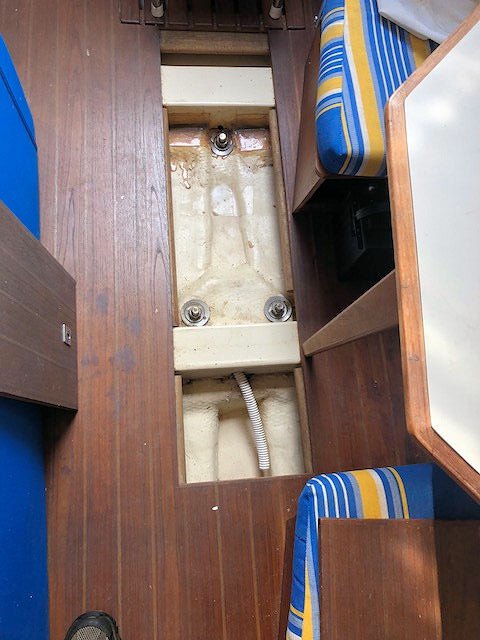

@Zephyr-Jeffer How about a few photos of the bilge. That would help. Not much info on the boat. Are you in salt or fresh water.

Pictures please of bilge

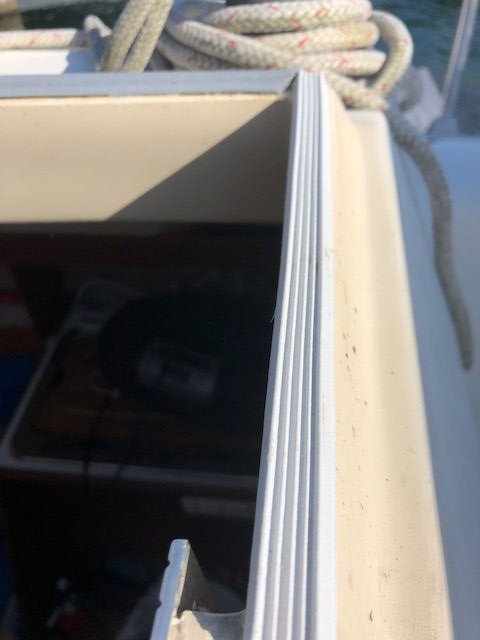

Over the last weekend I replaced the rubber gasket under the cabin pop-top.

Photos of bilge please. Also send a private message early next week so I can discuss easy method of finding leaks. One requirement is to report back what we discussed and leaks found topsides.

attached a picture of the bilge area - bone-dry. No water coming in from below; that was my main concern and the reason I started this thread. The goop that shows near the keel bolt is hardened epoxy that I did not apply - I only placed two layers of Flex Tape over a hairline crack that you can sort of see.
The other picture is of the new weather striping I glued down around the cabin top.
