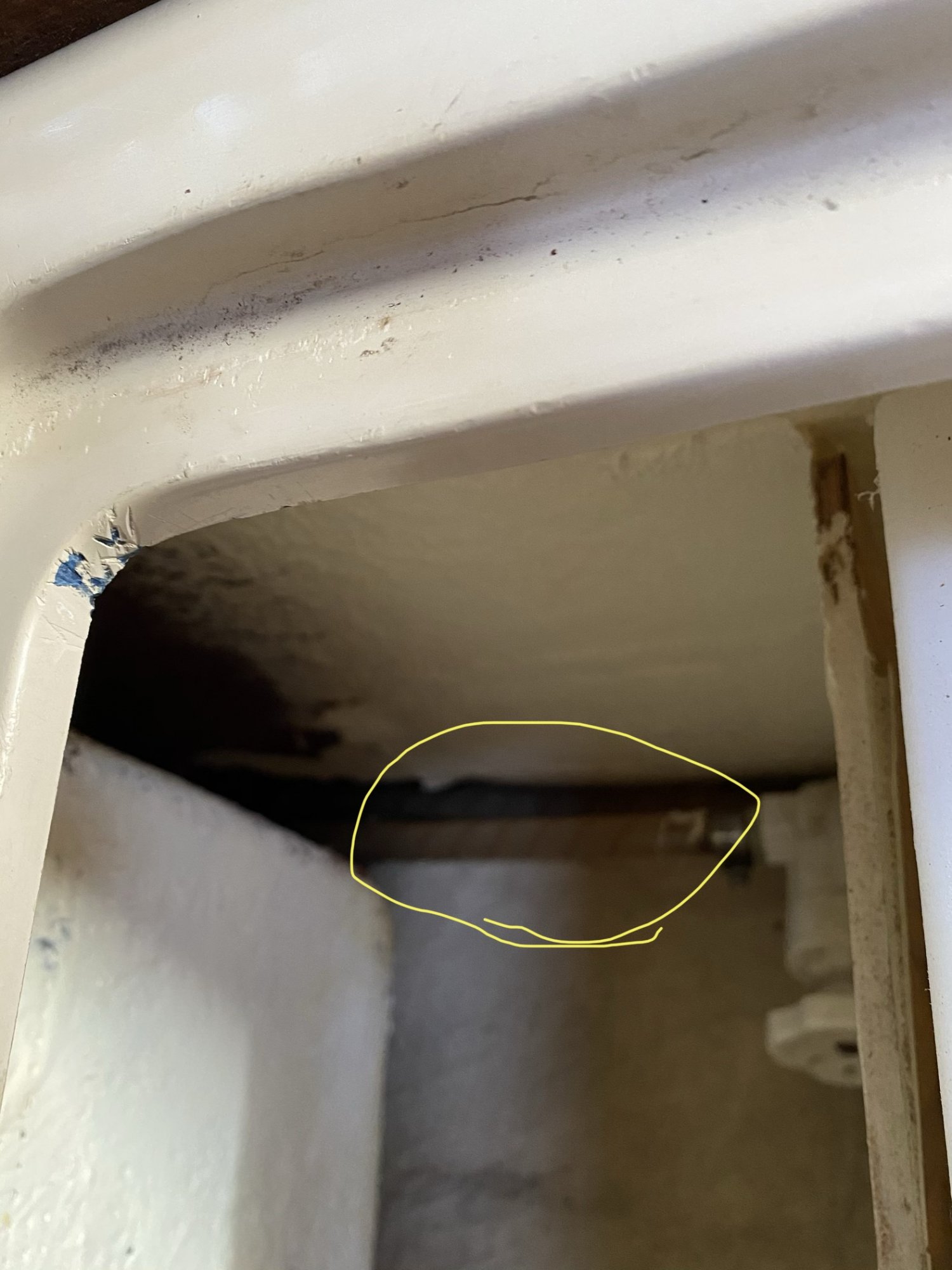

Roland, sorry let me clarify. I believe the leak is in the line that comes from the 25 gal forward tank to the pump. Specifically where the line is run between the hanging locker and where it pops out again next to the valve on the 17 gal tank. Let me see if I can generate a picture.

Mystery water solved:
So the valve was leaking slightly. But noticed still had water in the bilge this morning. Disassembled every access panel. Notice water is coming from under the kitchenette area. Check all the lines. Can’t find the leak, then I see the drain line from the icebox is damp. Poured a glass of water into the ice box and prove my hypothesis that the ice box drain is leaking. Plugged the drain to confirm its the drain not the box. Now how the heck do I access that drain?
Mjg407
Jan 12, 2020
22
Catalina 30 Coyote Point
Never mind, the drain hose isn’t attached to anything. So it just drains into the bilge. Brilliant design

On my C-30, the ice-box drain led to a pump at the sink.

The ice box drains to the bilge on most of these. Another water in the bilge source is stuffing box on the prop shaft...slow drip. my plumbing pressure pump cycles every 10 minutes because of a slow leak at the joints (working on that this weekend)...old stuff is a joy! I hate a wet bilge but have been dealing with it.
