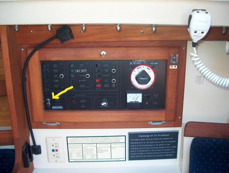

Good morning everyone,
I seem to be unable to turn off my water heater unless I turn off the entire AC service. There is a button on the panel labeled "water heater" (see pic) but it seems to do nothing. There is no "click" when you push it...is that a breaker that resets only when tripped, or do i have a failed switch?
Thanks in advance
-Steve
'90 C30 MkII #5757
23,101
Failed switch. Try Seaward for a replacement. IIRC, there was a recent thread about finding these pushbuttons, sorry, don't have a link.

Hey fox islander -- the breaker is a push on/push off. You can get them at Catalina direct or from Catalina. 20 amp, about $40
