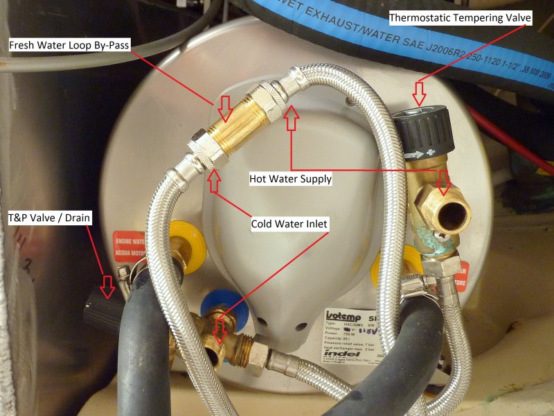

"Double Male" fittings are called "nipples"... Because a marine water heater is heated by an engine and can get to 180F or more I prefer to use brass fittings close to the tank. Once beyond the tempering valve and check valve you can convert to PEX. I will often use short SS braided hoses for supply and return line connections, to deal with vibration and then a simple 2" nipple can be used for winter by-pass.

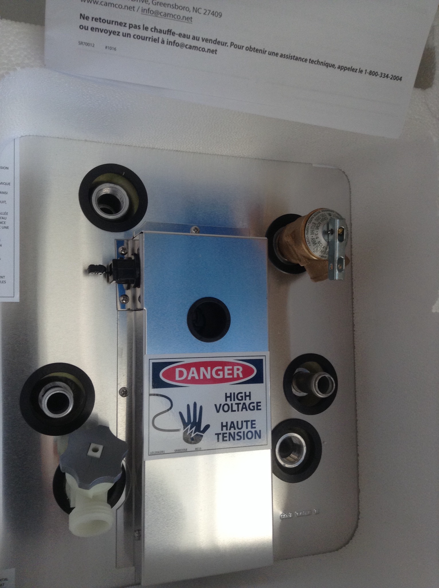

I will try to attach a photo of the partly disassembled old water heater showing the engine loop plumbing and the metal "double male" near the top of the heater. Both "double male" nipples corroded and basically "fell apart" where they connected to the brass check valve or elbow, I am guessing from dissimilar metal corrosion. I will also attach a photo of the new tank.

That's why I stop about 12" shy with the PEX and convert to flexible SS. For bypassing the tank in winter you simply unscrew the flexible hoses and put them together with a 2" nipple...

what a beautiful job, maine sail. wish I saw that picture of yours before i replaced my isotemp HWH last year. (without the stainless lines that can screw together for a by pass ...)
