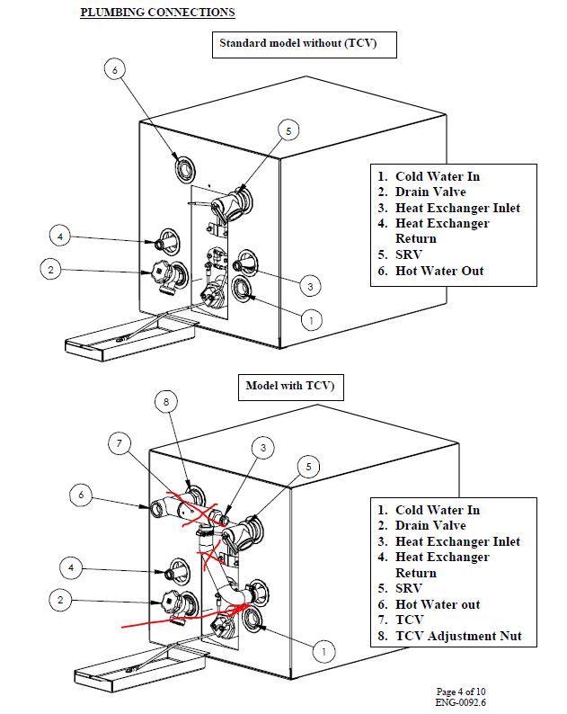

Hi All
Found my issue on weekend. My Forcer 10 Heater has a TCV (Temperature Compensation Valve) which designed to reduce coolant flow when water temperature reaches 60degC. Looks like my TCV was blocking majority of Coolant flow. I have removed TCV and basically convert my Heater to NO TCV version. After 20 min with Engine running I had water temperature about 60-65 degC. Have to get new one to make sure that I will not keep it too hot during long motoring trips...
Thjank you all for help and advices! My wife is happy now with her hot shower!!!!!!!!!!
