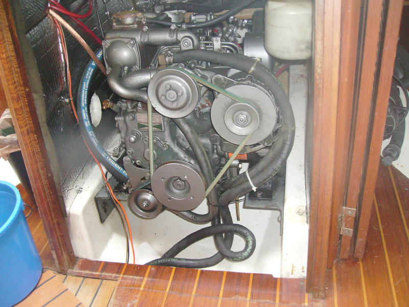

Water Heater Hose
Same here no loops, is run directly.. The red hose is the air conditioner pump discharge heading to the unit in the same settee as the heater.

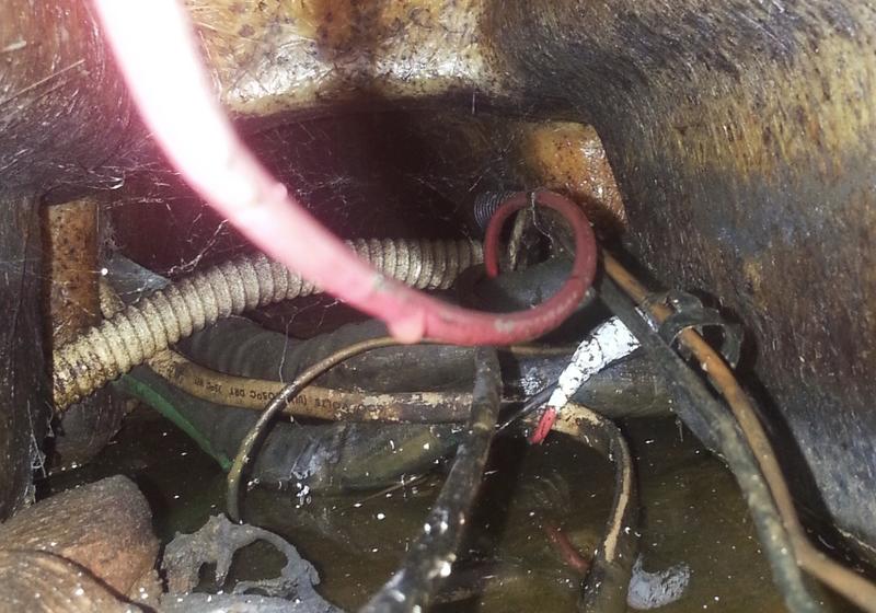

Thanks for the update! Did you burp your lines... As you may have seen I have had and engine cooling issue after I replace my hoses.
The picture show the deteriorated condition of the hoses under that stringer prior to replacing them. I also removed all that standing water/yuk at the same time. -Jon

How did you remove the sludge/liquid in the stringer?
PGIJon
Mar 3, 2012
856
Hunter 34 Punta Gorda
I made a small access hole with a drill circular saw in the stringer. I was able to shove the small nozzle from the wet/dry vac hose into it and then with the cut out, I repaired the hole with the cutout, fiberglass and epoxy. -Jon
