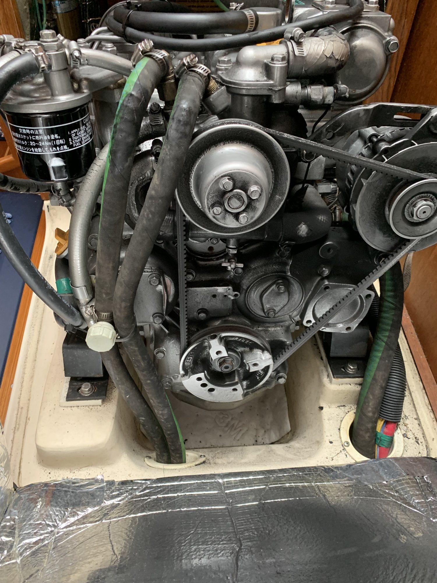

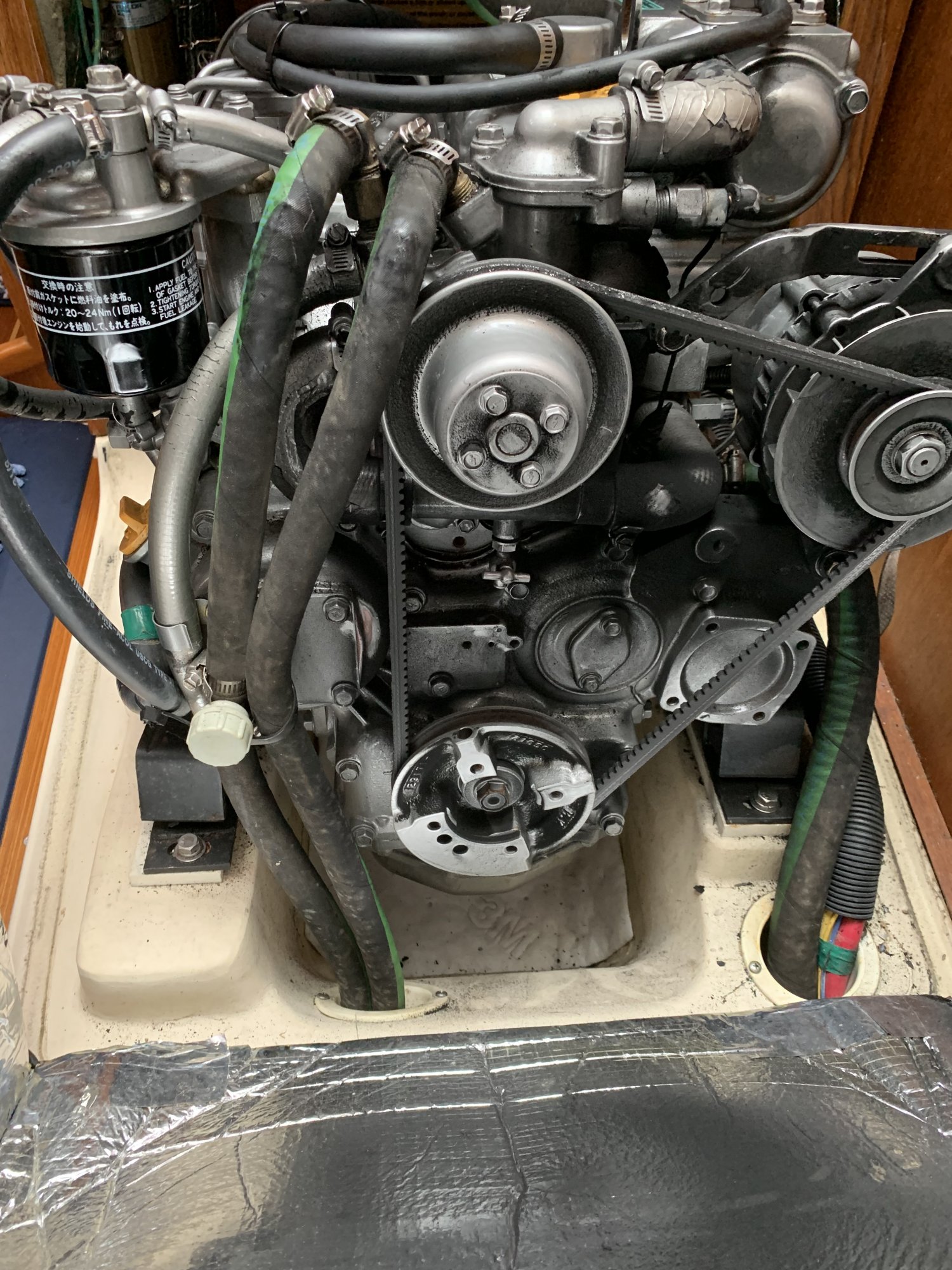

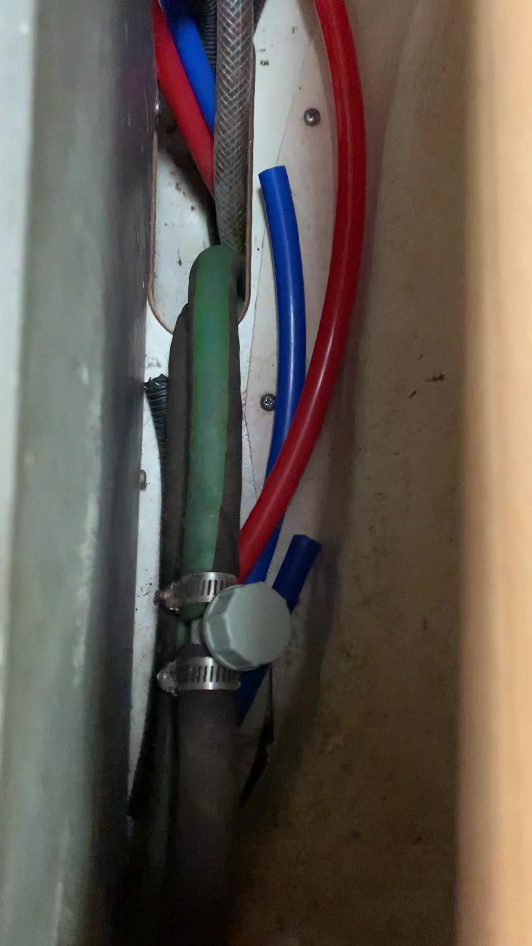

Hey Guys, I have 2 hoses that run from our Water Heater tank to our engine. Note 2 pictures. What runs through these lines, antifreeze or water? is this fluid isolated from the hot water tank via a heat exchanger? What maintenance and how do you do it? I note 2 connection caps, 1 at engine, 1 at hot water tank. Anything need to be done when winterizing? Thank you!

The hoses you show contain engine coolant. They go to the heat exchanger INSIDE the water heater. That's how the engine can heat your domestic water.
Regarding winterization, as long as your engine coolant is in good shape your are set for winterization. Note that engine coolant, like all fluids, requires a change after a certain interval (you decide). Personally, I like to change coolant every 3-4 years or so. If you don't know when the coolant was last changed, I suggest changing it. Be aware that the lines to / from the water heater tend to develop an air bubble when you change the coolant to be prepared to 'burp' the lines a few times.

As said, you are talking about 4 different systems…
1) water heater / engine circuit…engine anti-freeze circulated through engine and the hoses take the hot AF to the heat exchanger in the water-heater…this gives you hot water when motoring…no “winterizing“ of this circuit is required.
2) Engine raw water system…lake water pumped through the engine Heat Exchanger, and then out through the engine exhaust. This circuit needs to be winterized…pink AF sucked in the raw water intake, engine on, and run several gallons through the engine. Pink AF will flow out of the engine exhaust.
3) potable water system (red and blue water lines in your photo). Usually you have a water tank, water heater, water pump, faucets, all tied together with the red and blue lines For hot and cold water. This circuit needs to be winterized as well.
I generally drain my water tanks, drain my water heater, bypass the water heater, then remove hose from water tank, put the end of the hose in a gallon of pink AF, and turn on water pump and open each faucet (Hot and cold). I have 2 water tanks, so I repeat the process on the 2nd tank.
