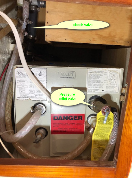

Thank you all for your input. I respect all opinions, but I'll have to agree with Dave and will keep the check valve. I attached a picture of what I have. I don't see a temp gauge or a way to set temperature. I may have an older model. I replaced the pressure relief valve myself with a brand new value a few weeks ago.

The picture doesn't help because we don't know for sure that the left side is COLD IN. If it is, it seems the cv is in the right position. Are you sure it's in in the right direction?
