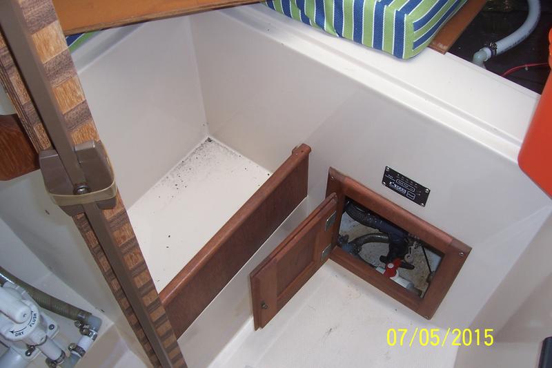

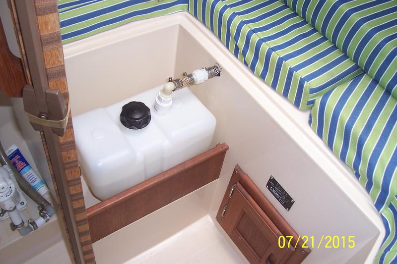

The next step was adding a fresh water tank to be used only for flushing the head. Fortunately the Catalina 25 has a compartment just aft of the bow holding tank area. A search of the internet found a supplier of poly tanks. A 4 gal. tank seemed large enough to handle the flushing needs for a long weekend.

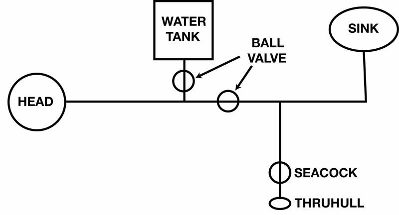

Using mostly the parts and hoses that were already there and reconfiguring the layout I came up with a manifold that allowed flushing the head using: 1) the dedicated head flushing tank water, 2) sink drain water or 3) sea water. Mostly, we will have the system set for using tank water.
Now the Admiral only has to contend with switching from Flush to Dry and pumping the handle.:dance:
Overnight, maybe...but a long weekend? I don't think so. The average flush uses about 2 quarts/liters (.5 gal), so that's about 8 flushes per tankful of flush water. You MIGHT be able to double that number if you only dry flush urine.
There may be another issue: I hope you didn't set it up to be filled from the fresh water system...'cuz if you did, you defeated the whole purpose of installing a separate flush water tank (which, since you said your head intake is teed into the head sink drain line, you didn't need). USCG regs require that any flush water tank have NO connection to the potable water system, not even shared venting, 'cuz it exposes the potable water system to e-coli contamination, same as connecting a raw water toilet to the potable water system does.
As for why you didn't need a separate flush water tank, search the archives for articles pertaining to eliminating head INTAKE odor...unless you also undid the intake line connection to the sink drain line when you removed the connection to the fresh water system, you're already plumbed to solve that problem.
