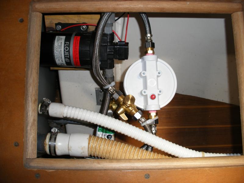

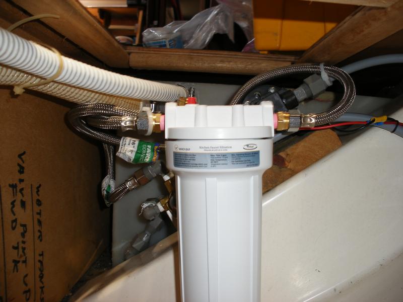

I have a whole house filter between the tank and pump on my H34. There is no problem pulling water through it for the two sinks and the shower.
- snip -
See pix attached.
DO NOT do this !!!!!!
Putting such a pleated filter on the suction side of a pump will most probably result in breaking and breaching the filter pleats.
Such pleated filters in this 'reverse' (flow from inside the pleat pack to outside the pleat pack) direction can only withstand 5-10 psi pressure drop before 'breaking' and tearing apart those pleats, much less if the 'pleat pack' does not have a molded structural polymer cage or perforated metal cage on the OD of the pleat assembly which 'helps' the pleats from 'blowing apart' due to pressure differential in the WRONG direction. This ('outside to inside of the pleat pack flow') is especially important with 'small' µM retention filters that develop LARGE pressure drops across the filter media.
In the correct flow direction, such cartridges can easily withstand 60 to 75 psi of differential pressure across that filter media.
Filters belong on the PRESSURE SIDE of pumps. Strainers are used on the SUCTION SIDE of pumps.
If you for some unknown reason MUST install a filter on the suction side of a pump ... install the filter so that the flow direction in the filter is from 'OUTSIDE the filter pleat pack to INSIDE the pleat pack'.

Appreciate Rich H's comment but these are whole-house filters intended for insertion in home water lines where the pressure is from 40 to 60 lbs PSI. They are rigged as per the manufacturer's instructions, with water going in the "in" port and out the "out' port.
They are Whirlpool manufacturerd to answer another question.
The dock's water pressure is rarely over 15 to 20 lbs PSI, so the dockside filter isn't being stressed. Aboard the boat I have a Jabsco ProMax-4 that flows about 4 GPM at a reasonable pressure. I doubt it it would do damage to the filter between the tank and pump, which doesn't appear to have had any internal breakdown each time I've examined it after changing it out each season.
