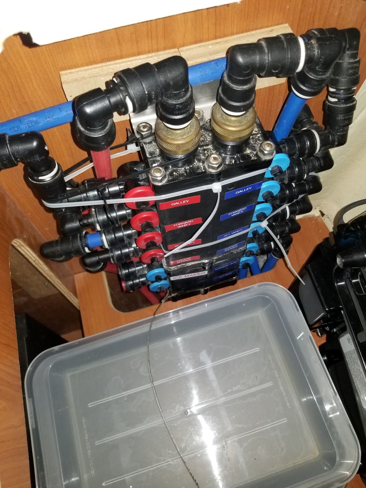

My boat has the wine frig option which has a low temperature designed for wine and not near cold enough for the way i prefer my beer. So I am thinking of replacing it with the ice maker option. Does anybody know what brand and model ice maker Hunter originally installed in the 49? It would mean running a water line but there is a spot on the water manifold for an ice maker which is open on my boat. So first thought is that a water line will be easy. However this is a boat so nothing is easy. The shark bit like connections on my water manifold have had trouble holding on to pipe connections recently. Over the last two years three have lost grip and will no longer hold the connection together under pressure so I have held them in temporarily (for 2 years now) with wire ties. I'd like to replace the manifold or find out if the is some way to fix the connectors before I start adding more pipes. Which brings me to my second question has any one else had this problem and what did you do about it? Also, does anyone know who manufactured the original manifold? I thought it was Seatech but if it was their new manifold looks way different. Lastly what size are the pipes in our boat I'd swear mine are metric which seems really strange to me.

15 mm pipe. My connections are dry. I recently added a filtered drinking water faucet to my galley next to the sink and didn't have any trouble with the fittings. You have to make sure the tubing is pressed all the way into the fitting. They will leak if you don't. Check the online store on this site for the manifold. I think I saw it there some time in the past while browsing.

15mm that's what I thought...it just surprised me they were metric ... The pipes are seated all the way in and they don't leak when they hold however surges in water pressure such as shutting off the faucet cause them to pop out and you know when it happens immediately as the pump goes crazy spraying water under the trash can all over the back of the small fridge. I have been wondering if it is scratches in the pipe ends that cause the connects to be weak and let go. I thought of cutting off a 1/2 inch of pipe and putting therm back together but haven't tried it. Don't know if it would work or not I was hoping one of you smart people out there in hunterowner land would have it all figured out for me.

Ok, so it is the ver. 1 Seatech manifold.
You have a few options:
Firstly, I would try chopping off 1/2” as you said, and really shove it in tight.
You can replace the whole manifold with a ver. 2 Seatech. It’s a bit of work to do this.
I actually bought spare Seatech valves a few years ago. If you want to discuss, pm me.

From the picture it looks like the pex tubing between the manifold and the 90° bend is not long enough, resulting in insufficient insertion, resulting in leaking. I would start by replacing the existing short pieces of pex by new lengths of pex with 2“ extra to be sure it is long enough. Really press it in hard. This should solve your problem.

The pipes are in the connectors all the way. I have no water leaks. The problem is the connectors letting go. There are currently no leaks and they are staying connected because the wire ties hold the pipe into the connector. They have been faithfully doing that job for 2+ years.
I think I will try trimming the pipes first and if that doesn't work I'll bite the bullet and replace the manifold.
I am surprised no one else has or had this same problem many of us have the same Sea Tech Manifold.

Apparently I have the same problem now with my pex pipes slipping out of the manifold. I recently changed pumps (5gpm) and added an expansion tank. This might have cause the pressure to spike. Has anyone tried trimming the pipe to expose fresh plastic yet? If that works, it would be great. Looks like the store has a replacement manifold that will work also. Or I could use the zip tie fix.
13,450
PEX fittings can be reused if they are not damaged. The ends of PEX tubing where fittings have been used, should not be reused. Cut off the section that was originally on the fitting. If the tubing is not long enough, splice in a piece using a connector.

Turns out the failure was not on the pex tubing. It was the black fitting where it pushes into the manifold. a couple of these fittings slipped out of the manifold during a recent trip. It looks like there might be enough plastic on the fitting to trim it short and then push it back in. I used the zip tie method for now instead until I hear from someone who has trimmed these fittings.

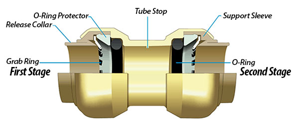

I've noticed on these Shark Bite fittings that it's helpful to fully seat the PEX pipe, then pull back on it in order to get the "teeth" to engage the pipe. Check out this diagram. When the release collar isn't pressed against the Grab Ring, the teeth engage with the pipe to lock it into place.
I have some fittings that are getting problematic about leaking. They don't last forever. New fittings aren't seriously expensive and can save some headache by replacing them when they start to fail.

The manifolds are from Sea Tech
Here is my suggestion
Always clean trim the end with a very sharp pex (or similar ) cutter
Then, put a small amount of Teflon grease on the end of the tubing (on the outside wall)
This makes inserting the tube all the way “home” much easier.
The way that people damage the 15mm Whake fittings is by jamming in rough tubing.
By taking a bit of care to prepare the tubing surface, you save wear on the fittings
