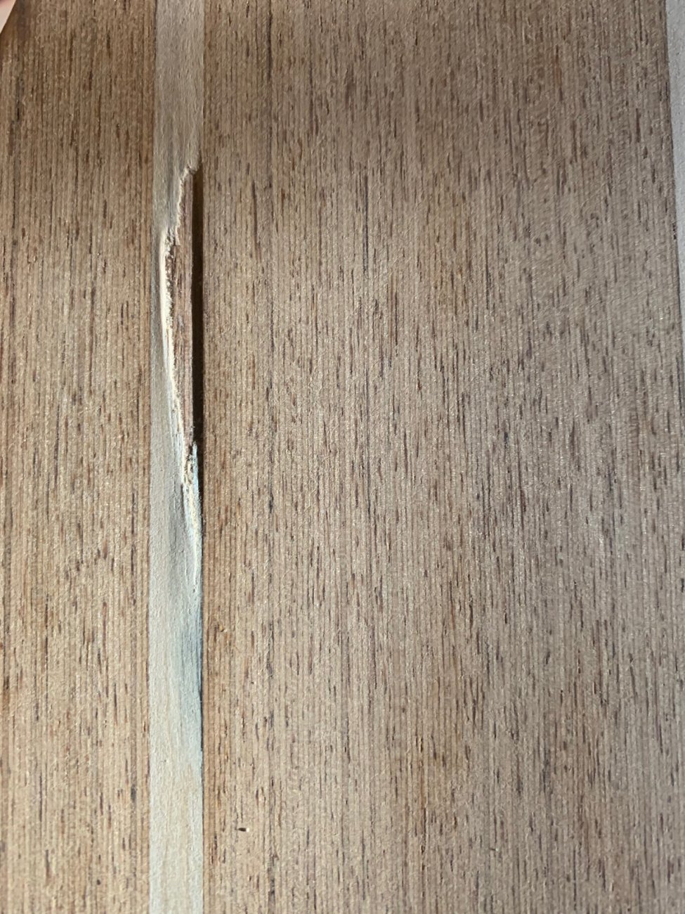

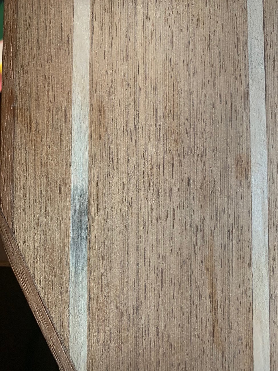

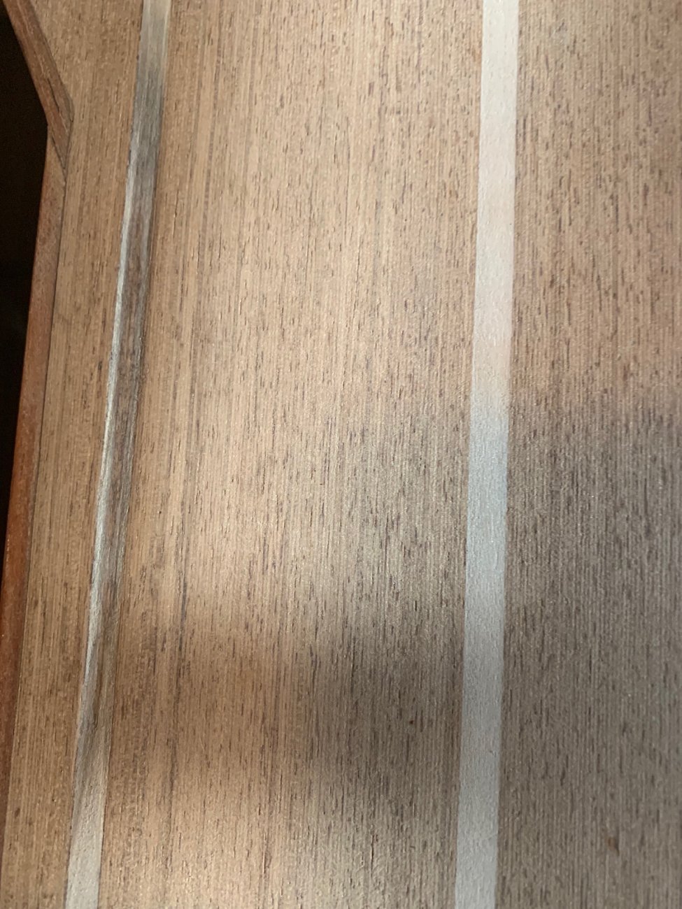

Here are photos of the 3 places where it seems to be too thin or missing. I was going to head to the Lowes and see if they have some kind of filler I can match the color, then varnish (and maybe epoxy first) over the whole panel. Any comments are well appreciated!
Jun 14, 2010
2,487
Given your apparent inexperience level, I suggest you consult with someone locally who does furniture refinishing professionally.
I doubt you will get a good partial refinish to blend with the original. So if you go it alone, your options are to either sand the entire areas then stain and varnish (or paint), or put down a new veneer then varnish. I’d recommend the latter for the table. Not sure about the sole because I don’t think your pics are good enough for me to judge.
