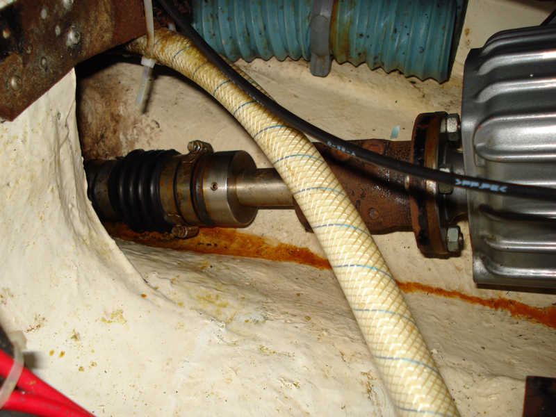

I recently saw that there was a little water coming in the boat and that it seemed to come from around the stern tube. I always get a little rusty water underneath my shaft and pss. Im pretty sure its not the pss. When i looked back at the pict i took before putting the boat in water, i remarked a rusty color, same color as I was getting in the boat under the shaft. Im wondering what could it be, and what should I do? When I hauled the boat out of the water the water I had inside disapeard...image-2747301741.jpg

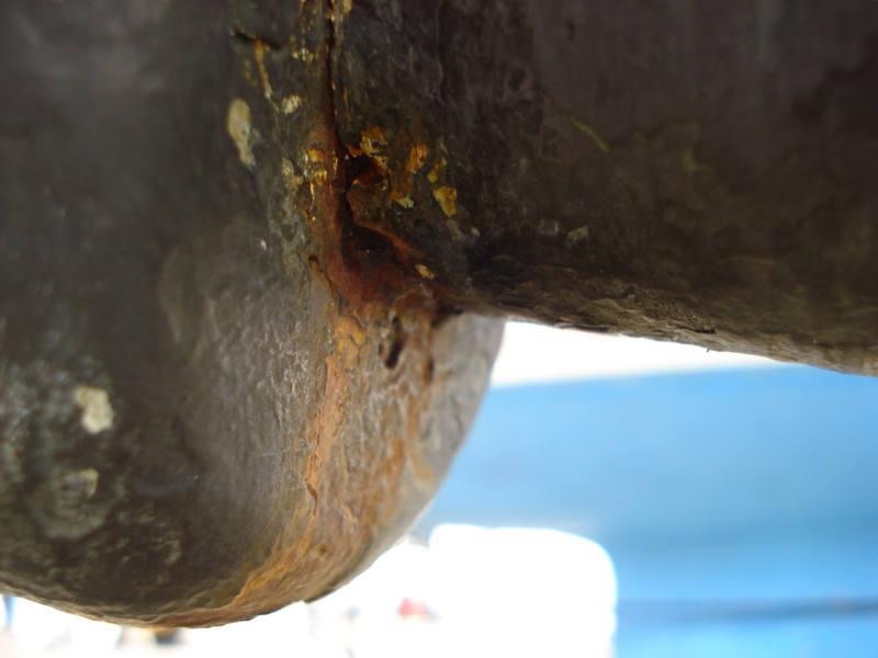

A closeup view! Im planning on grinding the paint/glass and see what we have here!
I also included a view from inside where you can see the rusty water! I was suprised to see that some water was remaining inside and no drip was seen on the outside... Maybe it needs to have a certain amount of pressure for water to come in/out...

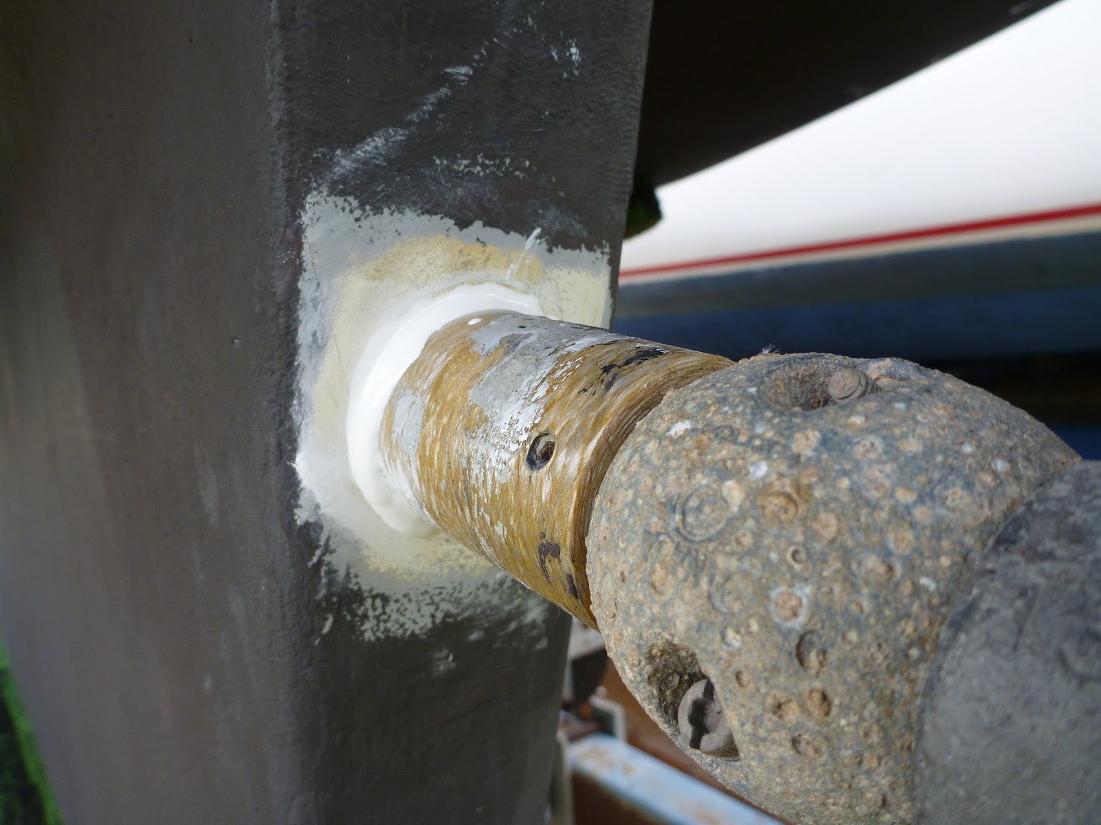

On my S2 8.0 I had this problem last summer and fixed it with 5200. I didn't have one leak all season! Unfortunately this Summer I thought the fix was still good but the minute I launched my boat the leak had returned. The boat is still in the water and not leaking right now but it always starts leaking after running the engine. It eventually stops during leaking during the week. It is the strangest problem. I'll be pulling the boat in a couple of months and anxious to see what's up with my 5200 fix.

This last picture shows a more serious problem than i would have thought as All the other boats i have seen had a naval bronze or glass tube and yours does appear to me to some type of metal that is in fact rusting badly
Rather than guess i would contact DUFOUR and confirm the material used
I have changed my sterntube and it is in fact a difficult job but i don't see how you have any choice :confused:

Manufacturers, I would hope and pray, wouldn't use metal underwater but who knows what a previous owner did to "repair" a problem!
You should be able to scrape a bit of paint off and see what the material is but it does look like corroded metal from the pic that Tom pointed out.

Thanks for the reply and the pict! Can you just paint 5200 with your bottom paint?
Let me know what happened with your fix!!
I pulled my boat a few weeks ago and the 5200 fix was all mush and I peeled it right off. I have a new problem as I can rotate my stern tube by hand. I have a fun project for the Spring! Good luck with yours.

Odd that there would be red oxide showing up in the stern tube area. One picture appears that the tube is completely rusted through. My boat, when new, appeared to have caulking around the outside of the tube as in the photo of the 5200 application. I have just been in the habit of replacing the caulking with the black boat life type that is supposed to be good for underwater application when I paint the bottom. Fortunately, the caulking has has held up, and I have not experienced and water encroachment.
