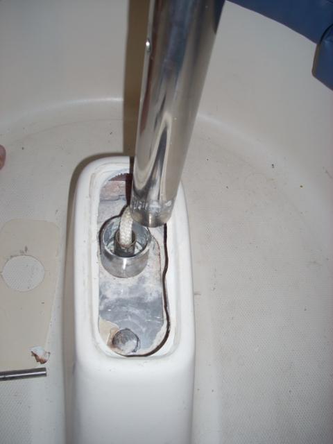

At the risk of reviving a dead thread and a bad idea (IMHO) I stumbled across a pic of the tank lid access port and drain pump that somebody had mentioned above.
Do with it as you wish.
