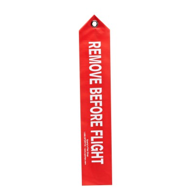

We have a little plaque (cut out of a credit card type plastic) that has velcro attaching it near the compass that says "board down" in red on one side and "board up" in black on the other. Pretty handy when coming into shallower water. Just a thought, if you are new to a variable draft boat.
I've thought about getting one of these and putting it on our keel screw when it's up. More for fun, you can definitely tell when the keel is down vs up!
Likes: FDL S2
May 17, 2004
6,232
My father in law worked on the flight line in the Air Force years ago. He ended up with one of those tags and handed it down to me. I've been looking for a cool application but sadly I don't have a retracting keel.
FDL S2
Jun 29, 2014
485
S2 7.3 Fond du Lac
I've thought about putting one on my shore power plug after I came VERY close to backing out of the slip with it plugged in.
